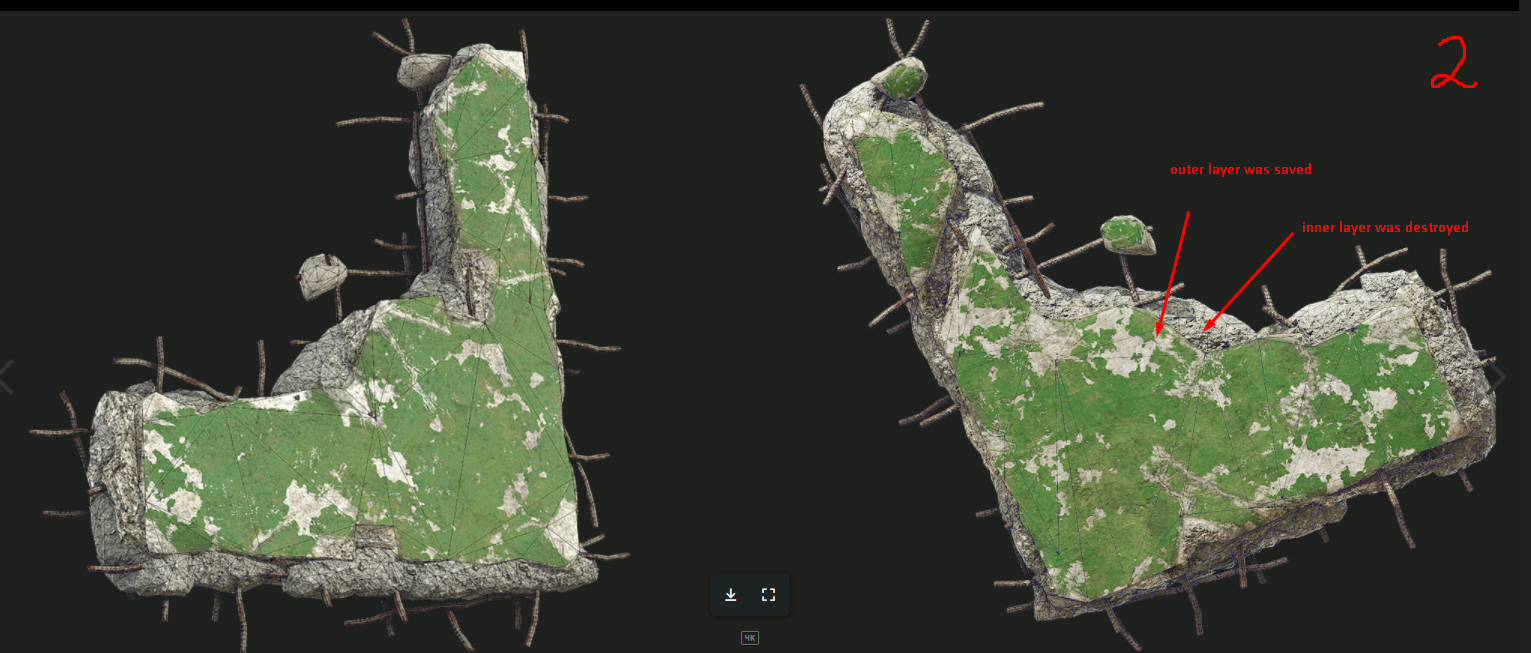

I am working with models from a finished game in Unreal Engine 4. I am trying to destroy a wall, but the concrete is breaking down in large pieces. This is unrealistic because destruction is not multi-layered. There are plaster, primer, reinforcement and other. I need the destruction to happen gradually. The inner and outer layers were destroyed separately from each other (like the second picture).

You got to think realistic on this one. If you want the destruction to feel like there are different layers then you need to model those different layers, fracture them based on their shapes/structures. Then constraint them to each other. Do your sim and it'll look like you want it to be.
