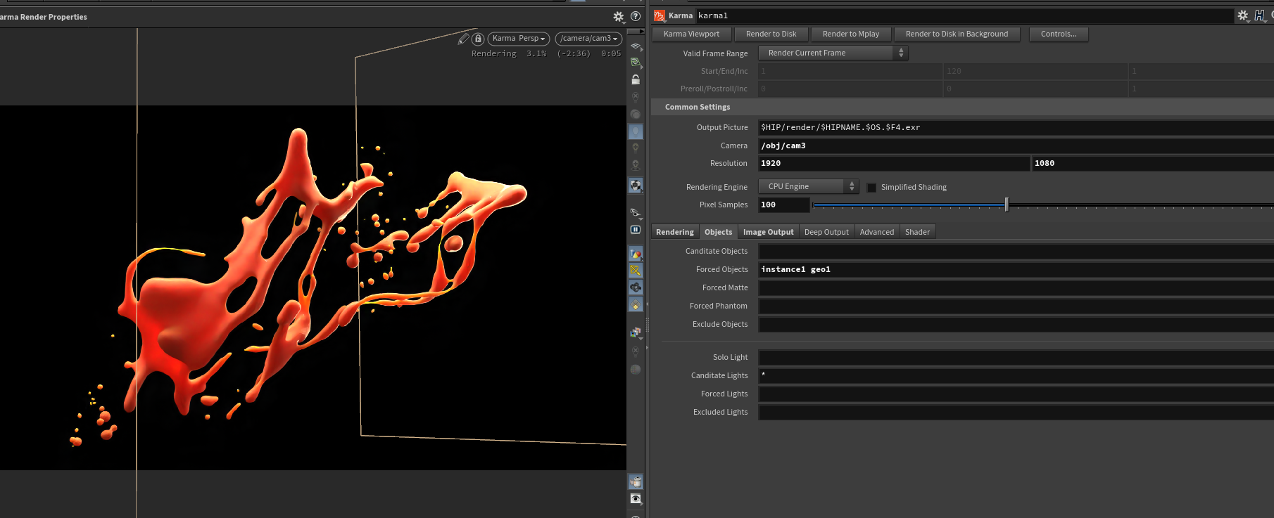

Hi guys, H19 is great! currently I'm playing with Karma ROP, it works really fast and XPU alpha is ultimate.
I am trying to use instance node to instance some geos, I can see the instances are working in the sceneview, but not visible in the karma viewport, does anyone face the same issue? or am I doing something wrong
Screenshot 2021-10-28 131333.png (746.1 KB)
Screenshot 2021-10-28 131351.png (94.4 KB)

I can see my main splash in karma, so im sure all works good in the scene except the instances.
Screenshot 2021-10-28 131544.png (357.8 KB)

8043 posts
The instance node won't work. Use packed geos.
