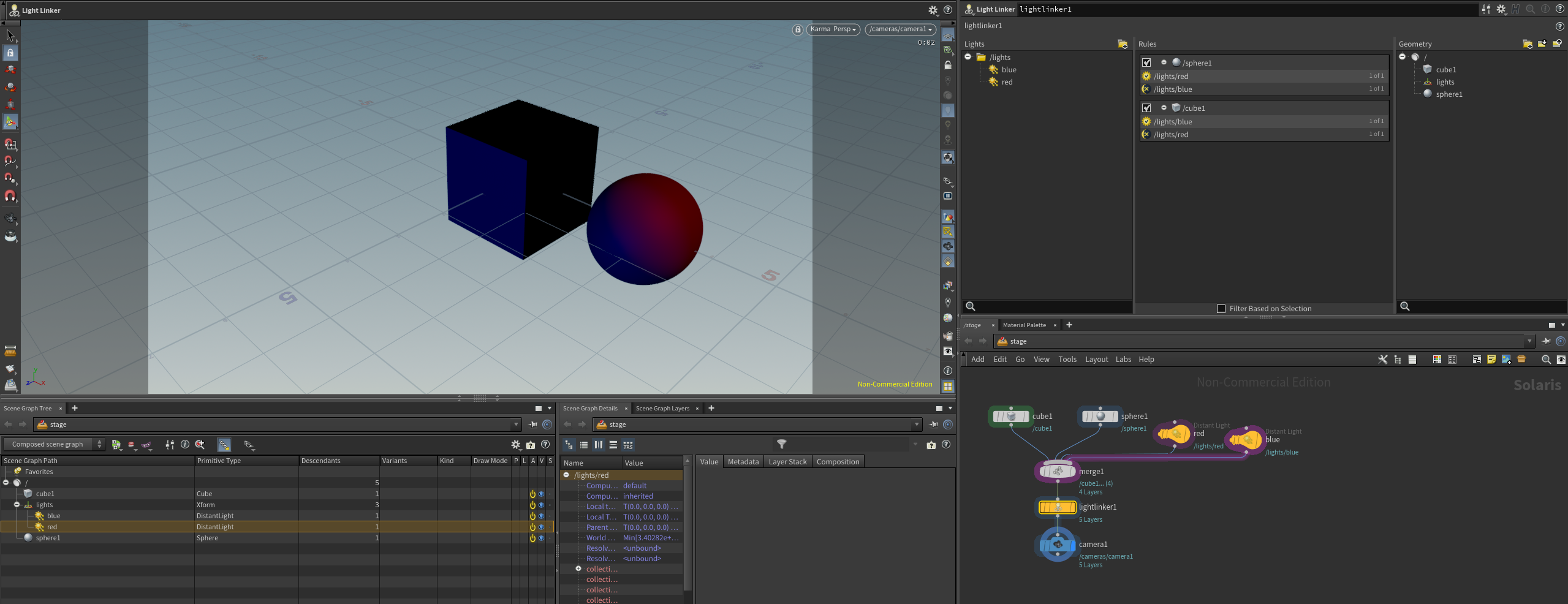

Hello!
I am experiencing something similar (im on the latest production build). I am totally new to Solaris, but since i can work with a basic scene, i added a light linker to control which objects get illuminated by which light.
The thing that happens is, in the process of adding rules in the light linker, some of my objects get no light even though the rule says it should get one. This way the geo simply becomes dark, and if i restart the render a couple of times, sometimes it fixes it, but usually it behaves something like a bug, and i can't get it to work really.
In the video from Rohan Dalvi on youtube, where he shows Solaris, his light linking works without problems.
