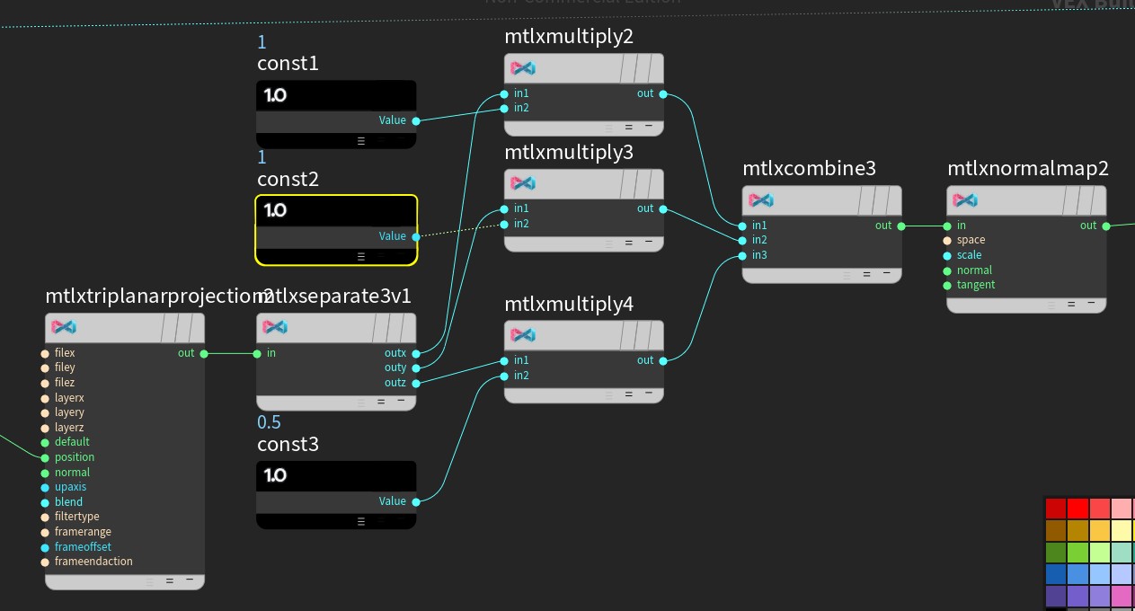

Old post, but I'll add here for posterity. Set the normal input in the triplanar to Vector 3 > add an mtlxNormalMap node > set to object space > outputs automatically to world space > plug into normal.
In Unreal this can be done with a vector 3 multiply setting R and G to the X strength multiplier and leaving B at /X. Other renderers
just have a strength float built in, but I can't see how to split out the vector 3 in MatX?
This is how I set it up in MatX. Strength effect working as expected.
EDIT: actually it isn't working as expected. Back to the drawing board....

Danny McGrath
MaterialX is lacking the required building blocks to implement this.
Required steps:
- Planar projection x3 ✔
- get blend weights from normals with respect to planar projection space ✔
- compute tangents with respect to a projection ❌
- build matrix from row vectors ❌
- transform normal using a matrix ✔
- blend vectors in world space ✔
- surface material accepts world space normals ✔
actually, this might be possible now, I see create matrix nodes and creating the tangent space could be done by projecting the space bivectors to the surface using its normal.
Edited by jsmack - July 21, 2024 13:29:39

I was going to set it up using the Karma triplanar hex shader but the map input doesn't have vector 3 for the normal map.
Thanks for the detailed breakdown. I'll look into the create matrix nodes.
