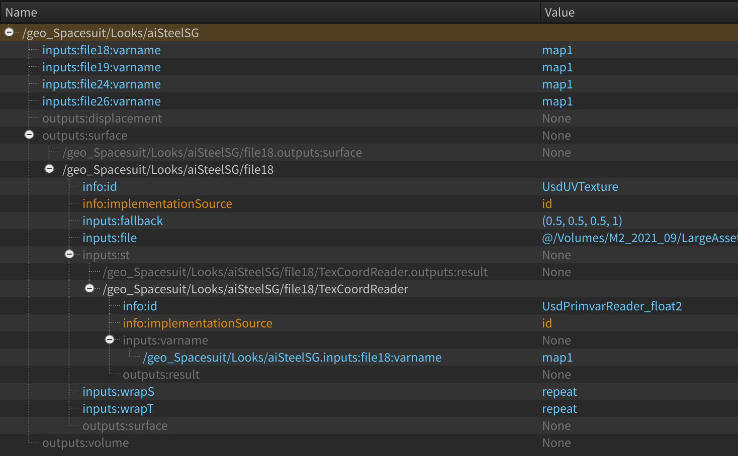

Unfortunately, the preview shaders don't look like they import correctly. Only one of the texture maps is mapped to emission.

Your export is broken. It's missing the shader part of the material. The example has the texture reader connected directly to the surface shader output of the material. There should be a USDPreview material in there between the textures and the material output.
Then that means Maya 2022 USD export is broken. I'll post to the Maya/USD forum to see if there is a fix on their end.
