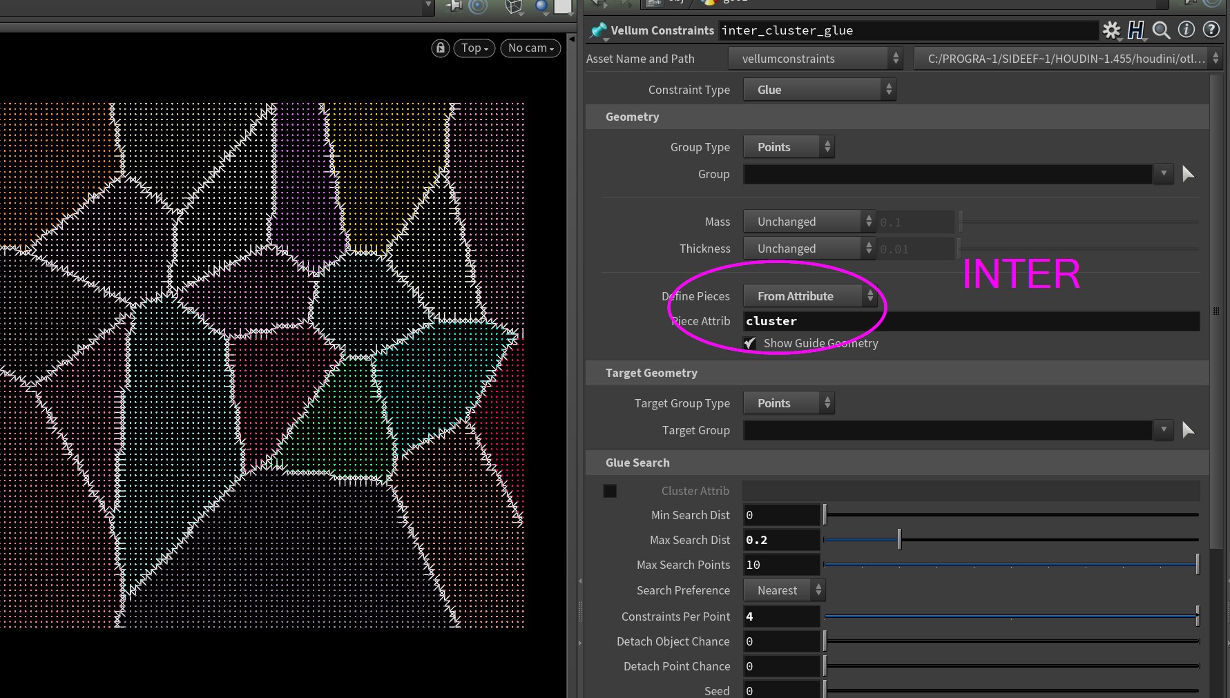

You can do this with two sets of vellum glue constraints. "Intra cluster" constraints to hold the grains within the clusters together and "inter cluster" constraints hold the different clusters together near their borders. The trick is to use the cluster attribute in the "Cluster Attrib" parameter on the intra node and in the "Piece Attrib" parameter on the inter node.

Beautiful, thanks! I was tipped off to the the "inters" on an Od/Force thread, but the intra is good to know, too, definitely.
