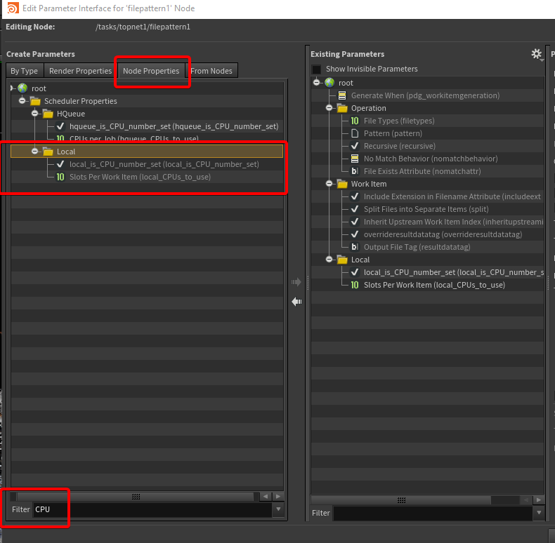

not sure if it's gonna help but there is this folder you can move to the read node.
might help in combination with frames per batch?
