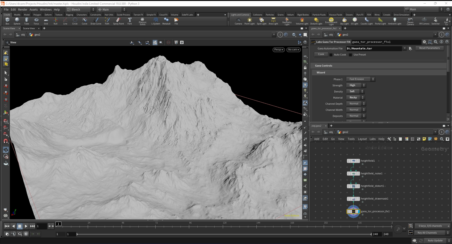

I'm also running into this issue. It's really strange. If you check the python script from the Tor Processor Sop, you can find the command that gets run to start up the Gaea build process. The problem is that the command that is supposed to run works perfectly if you run it by hand in command prompt, but if you try to let the sop run it, it fails. It fails to generate the automation xml file, and even if you run the batch command to generate it yourself, it then fails to properly start the gaea build process.
If anyone wants a quick fix, I managed to do a couple of hacks to the Tor Processor Sop. It works for me (although I haven't tested it in PDG). I'm attaching the .hdalc. All you have to do is to import the asset and use it in place of the original processor.
If you want to convert it to a .hda(from .hdalc) all you have to do is copy the script section from the node type properties. Everything else in the asset is unchanged from the original tor processor file.
I'm using Houdini Indie 19.0.589 and Gaea Professional 1.3.0.13.
Here's an example of it working (also works with masks).
If you get issues with the height map coming back remapped to a smaller range of height values from gaea, just go into the gaea build tab (build manager) and set the output to Raw. After that save the .tor file again.

The previous hdalc didn't correctly work with color maps. This new one should also transfer the color maps. This hack isn't so seamless as it forces you to respect a naming convention for it to work.
Basically you have to name your color map with the same name you used in Gaea, and you have to not use any double underscores in the name. So no "__". You can use one underscore, but two consecutive underscores will break things. EG: Base_color_out is OK, Base__color_out is not.
I'm uploading the new hdalc here. I'm leaving the old one in the previous reply, in case maybe I broke something
Here it is working with colors.
