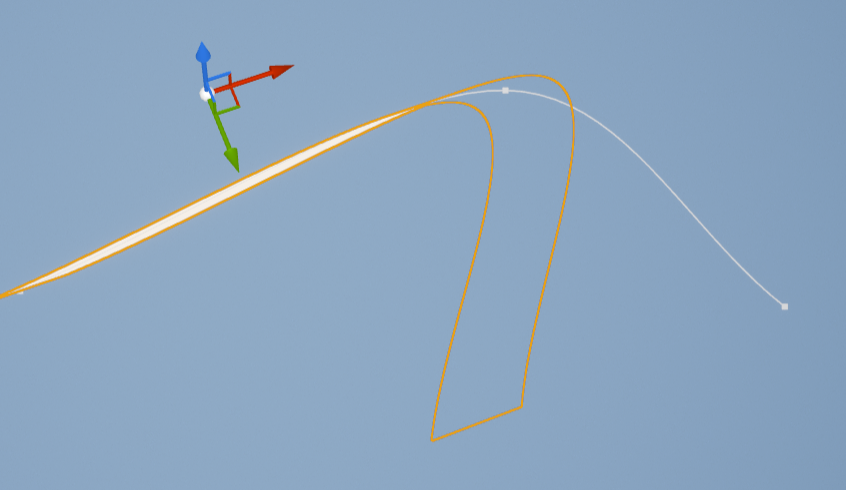

I used SplineComponent in BlueprintActor to set my HDA input,but it doesn't work.
The log said:
LogHoudiniEngine: Error: Houdini Engine Session lost! This could be caused by a crash in HARS.
LogHoudiniEngine: Error: Hapi failed:
LogHoudiniEngine: Error: Hapi failed: No valid Houdini Engine session.
It was normal in UE4.I'm sure I used the same operation.
My version:
Houdini 19.0.531
Ue5Preview2&1
Thanks a lot.
HDA has problems using SplineComponent input in UE5Preview?

Hi, I have the exact same issue.
The HARS crash happens when you move a point on the spline component of a blueprint that is hooked to the HDA's world outliner input.
It happens in both UE5 and UE4.
My main goal is to save splines with the UE level and use those as inputs for my HDAs for further processing.
LogHoudiniEngineRuntime: Display: [UHoudiniAssetBlueprintComponent::NeedUpdateInputs()] Inputs need update for component: /Game/Developers/tomvelebny/Collections/Levels/LevelTest.LevelTest:PersistentLevel.HoudiniAssetActor_UAID_3C7C3FF50E6A250401_1167386896.HoudiniAssetComponent

Thank you for your reply!
I tried it in UE5.0 with H19.0.589.
The first time it worked,but still reported Session lost when i moved the spline.
