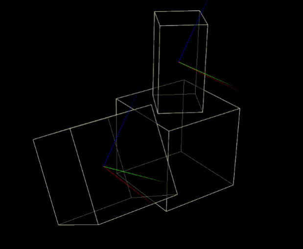

Here's a quick example showing how you might setup some conetwist constraints to use with the RBD Bullet Solver SOP.
Notice I'm only driving a few of the conetwist constraint properties via attributes on the constraint prims.
If you want different settings per constraint for other properties, you'll need to add them as attributes and make sure their default values (which will be multiplied by the prim attributes) on the RBD Bullet Solver are set to 1.
The tricky thing with the conetwist constraint would have to be the motor_target. It's not very intuitive in the slightest. While the parameter on both the RBD Bullet Solver SOP and the ConeTwist ConRel DOP specify a motor_targetr vector param, you need to set a quaternion motor_target attribute. This attribute needs to be updated at every timestep, so make sure you add it to the list of constraint attributes to be updated by the RBD Bullet Solver.
Thanks, npetit! Just before finding this, I managed to get something in that worked however seeing your motor setup has more implementation possibilities. Thank you so much! I converted your VEX to vop with success but whatever my setup is doing, I supposed I need more work getting that working.
Hi, Thank you for your example file. In the file I noticed the same issue that I had when using a motor_target, that the motion is a bit "twitchy" it does not follow the same smooth rotation that the "driving" motor_target has. You might see in the gif that the visualized motor_target attr has a smooth rotation but the simulated object occasionally slows downs, and speeds up again.
Is there a way to use a motor_target and get a smooth motion?
The reason I want to use a motor_target on the cone twist constraint is do "drive" the wheels of a vehicle. Is there another "preferred" way of doing this. I have tried using v@w on the wheel objects but had some issues with "balancing" the force of the angular velocity.
Does anyone have some tips on how to drive the rotation of an rbd object in a stable and controllable way?

A lot of work has gone into improving the Cone Twist Constraints for H20 - I think you'll be pleasantly surprised. The Hard Constraints have also been improved, making it a lot simpler and straight forward to setup fully featured vehicles for example.
The motor target on the Cone Twist Constaints however are defined as quaternions, which means they're best suited for ragdolls than for fast spinning objects such as wheels. It's still best using Hard Constraints for these.
