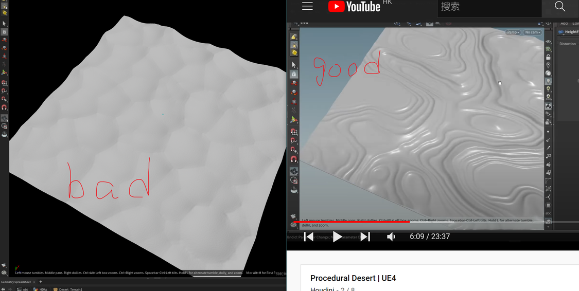

I am following a tutorial 18.5. The viewport preview specular of the terrain are very convenient to observe the shape. How to make it consistent in the 19 version

Viewport - press D. Lights and Material tabs. Add some light. Not perpendicular to the geometry plane. Copy a one-to-one training setup for an objective comparison. Maybe the problem with the geo, not in the program
