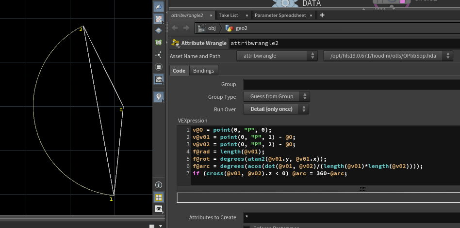

Given a prim with three points, prim pt 0 always being the center, how do you reverse engineer a Circle primitive to rotate on Z axis so it points towards prim pt 1 and then work out the arc over to prim pt 2?
I've mocked it up roughly here but the numbers aren't correct.

How about something like this?
arc_from_pts.hip (189.6 KB)

Thank you, that's really helpful!
