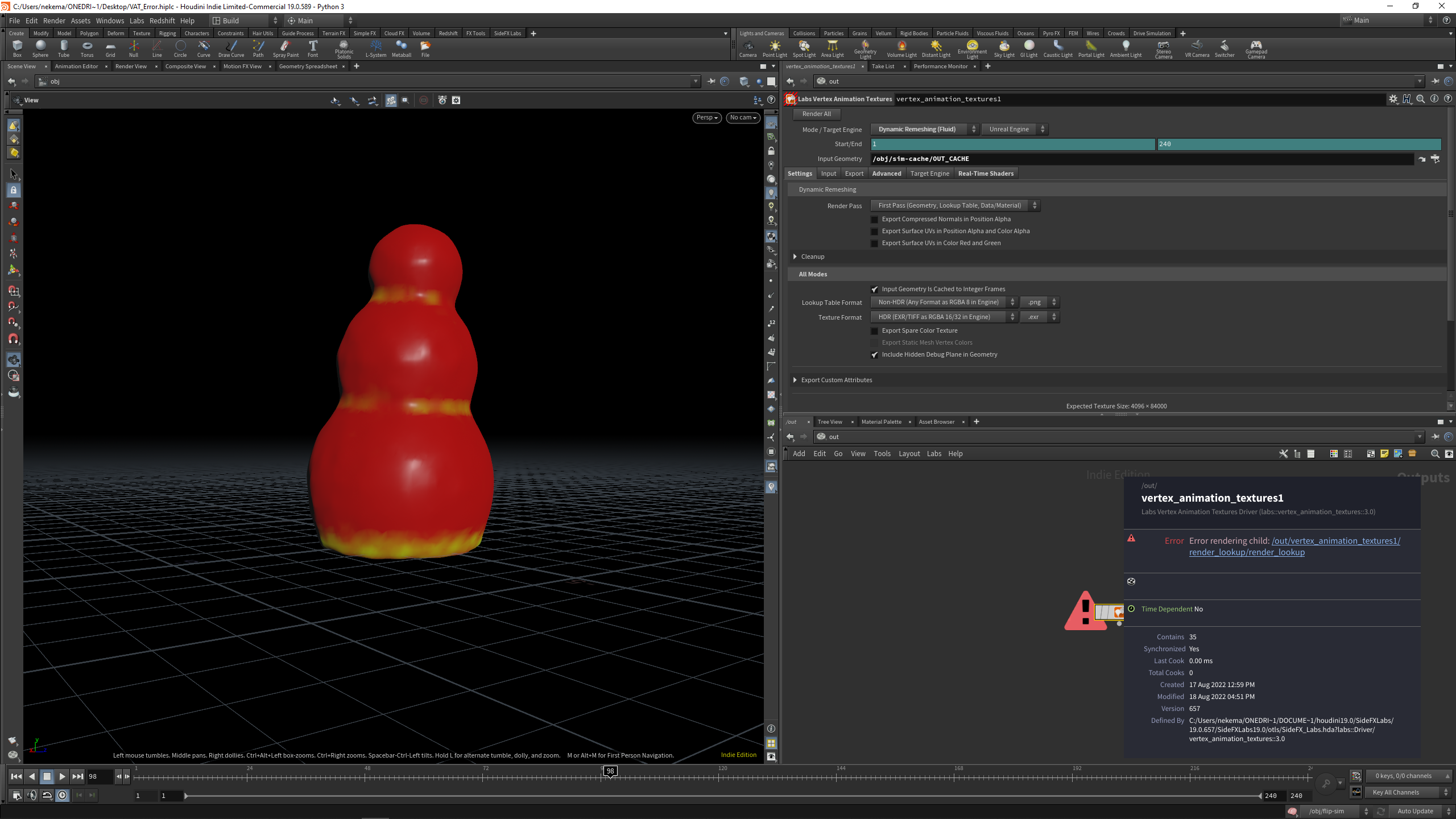

Hello, I am currently running Houdini indie 19 and I am encountering an error when I try to render some fluid. I cached out the fluid and tried a few different things from the forum posts I've seen on this issue but no luck so far.
The .fbx gets generated but the Lookup texture doesn't get generated and then this error is thrown: Error Rendering Child: /out/vertex_animation_textures1/render_lookip/render_lookup
Any help would be appreciated!
I'll attach a project file that has this issue occurring on my machine
Edited by nekema - Aug. 18, 2022 17:07:04
VAT_Error.hiplc (1.2 MB)
