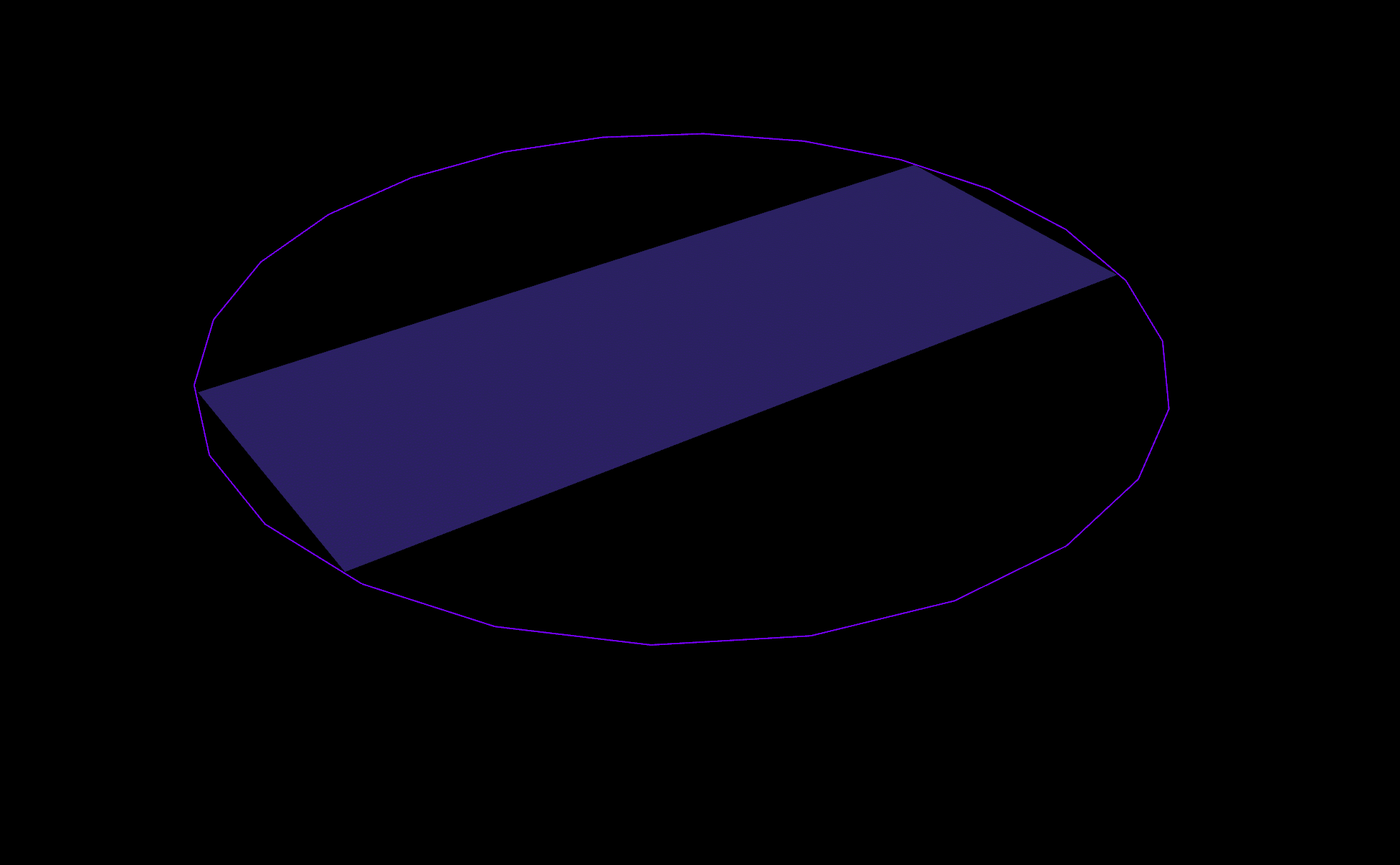

I'm trying to build a simulation where a cloth is attached to a flexible metal ring.
during the simulation, the cloth should shrink and deform the metal ring. but to get a realistic behavior I need to apply gravity force only on the cloth object ( and this part is my issue now).
note that I can't pin the ring points because they need to move according to the shrinkage of the cloth movement.
Thank you in advace.

use POP Force DOP inside instead of using Gravity Parameter
so that you can specify group or VEXpression to limit its influence
