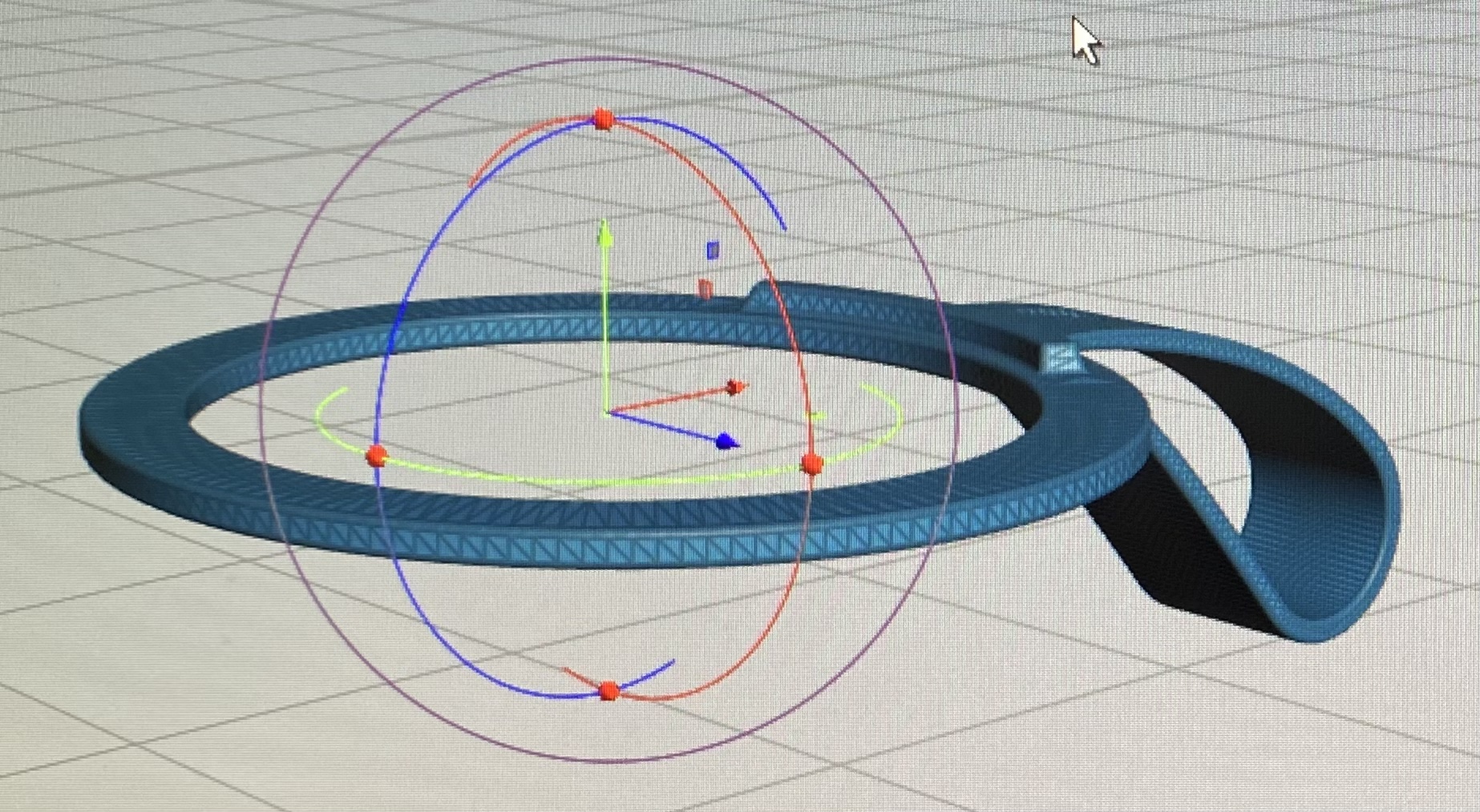

Hi, I would love to know more about this too!
I got a component that is part of a product. (please see image attached) I would love to rotate it around a very specific pivot location, preferably without the use of sop_modify.
Isn’t There a way to define a pivot attribute before importing into lops?
Thanks in advance!
Best
Chris

But how would you center the pivot inside the circular opening of the strap model I posted above?
Neither center pivot or bbox will work in this case :-)
In the image, I positioned the pivot in Sops with the help of selections and the construction plane. But how do I get the pivot into lops?
Or is this a sop_modify thing?
All the best
Christian

Thanks a lot from me as well! These informations are very useful!
All the best
Christian
use the ch function reference them from SOP to move the pivot inside the LOP transform.
This is the way I can think of, because USD seems to store 4*4 transformation matrices directly, and does not store pivot information separately, of course you can author a pivot attribute and use USD pyhton API to access them.
