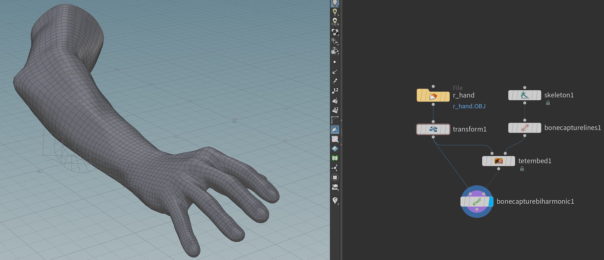

Unfortunately, this is exactly the same setup as in the pdf and in the vimeo tutorial, so it is how SideFX suggests setting up the rig. I tried tetconform and got the same problem and changed the settings. I think the downloaded bgeo.sc file must be bad. I downloaded again and tried the daily build and got the same problem. The rig is present (see attachment)

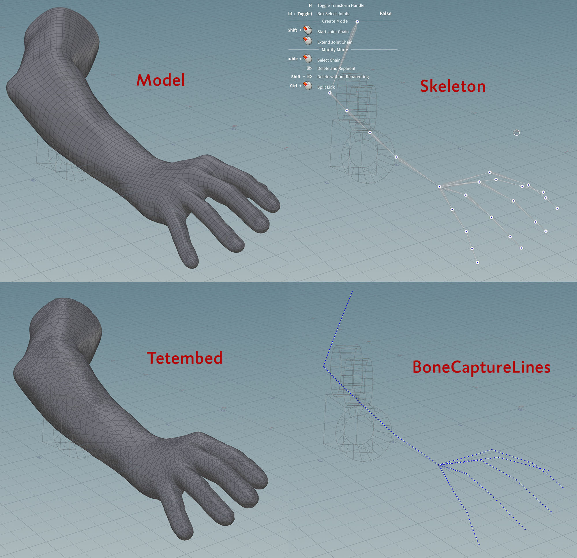

I am struggling with KineFx. The old bone system was quite reliable. Here is a hand model with skeleton and bone capture biharmonic doesn't assign any weights. I have double checked by adding a visualizer for weights and it is all black. Here are the steps that work fine until the bone capture biharmonic is added. I've tried tetconform as well and played with the settings of all of the nodes without success. Any suggestions?

Now I just destroyed my capture to redo a biharmonic. It worked on first attempt. This is Houdini 19.5.403.
Make sure your inputs are valid. For example the tetembed must wrap the entire source mesh. Check Enlarge Offset.

I'm checking your scene. For a start. In your skeleton mirror node change L_ to l_ and R_ to r_ otherwise your mirrored joint (bone) inputs are corrupted. Then if you add a capturelayerpaint node after bonecapturebiharmonic1 you can not select and see your Capture Regions to paint them.

Thank you very much! It appears there are two separate issues. The inability to capture was user error due to my capitalization. But there is a separate display issue. If I set visualization to bone capture, it only works if I have single bone visualization selected. The biharmonic capture node itself is supposed to show the visualization. I think this is the bug that SideFx has logged.
Fortunately I was able to do weight painting, add a delta mush and set up a rig for the hand model, so all is good.
