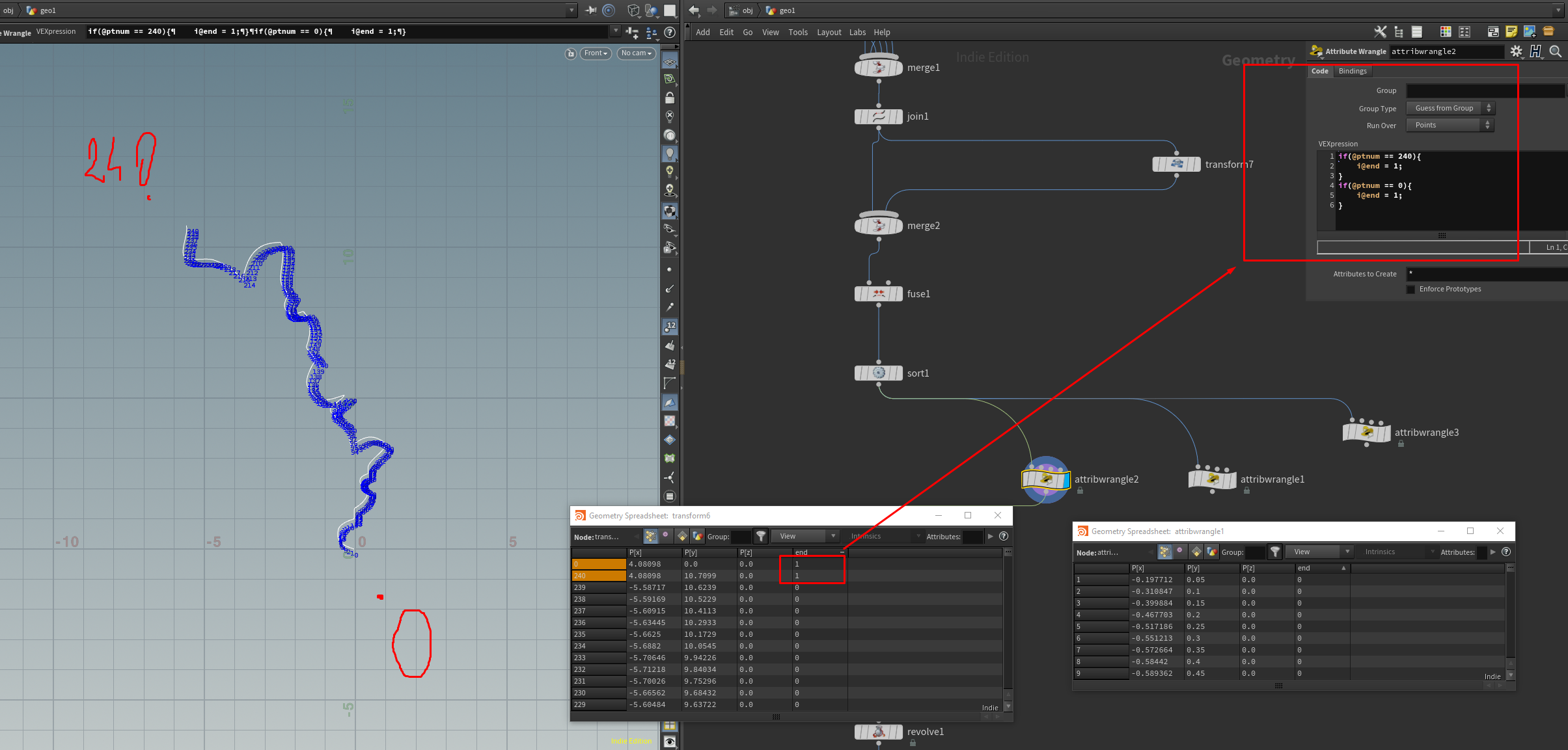

Hello! I heve 241 point, an i want to get te first and the last point,and i name them i@end =1
if i maualy enter total number, i get this:
if(@ptnum == 240){
i@end = 1;
if(@ptnum == 0){
i@end = 1;
and it is working, but if i want to make it change prociduraly:
if(@ptnum == npoints(0)){
i@end = 1;
if(@ptnum == 0){
i@end = 1;
i don't get the right result

npoints(0) returns 241
the time i sent it i realizet that i have to put -1 in this function)
Thank you!
