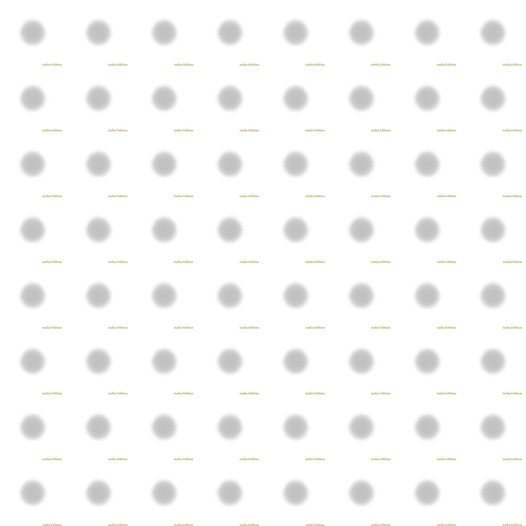

When Labs Flipbook Texture is used, a watermark is printed.
I am surprised because it was not printed before. Has anyone else checked this out?
The version is Houdini 19.5.534 and it is windows11.
I'm attaching the files and images and would like to hear your opinions.
Thanks in advance.

I found the cause of the problem.
It seems that the otls file contained an apprentice file which was put in as an experiment.
When I removed them, everything worked fine.
I hope this topic will be helpful to others who may face such problems.

Hi.
I seem to have the same watermark problem.
Would it be possible for you to tell me, where did you discover and remove the apprentice files?

Thanks for reporting this. The explanation and official fix are posted in this thread [www.sidefx.com].
You need to go to the node's Interface tab and set Viewport Padding and Padding Direction (to the right of Viewport Padding).
