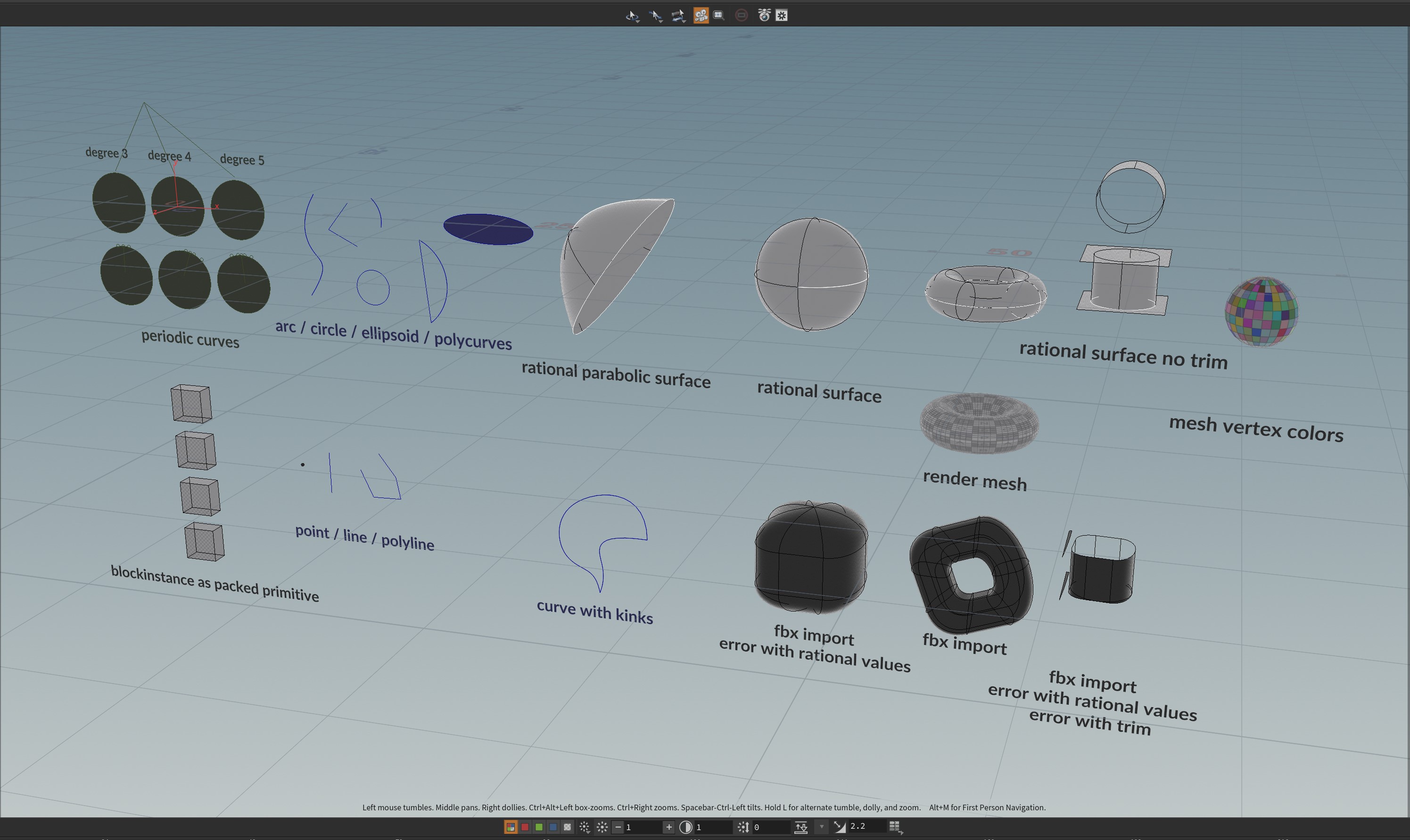

In this screenshot i can show that i already can import some object types, needs more work and testing though. Here you can see that fbx nurbs import is not sufficiant with rational nurbs data. I know there is iges too, which works well, but is unstructured.
