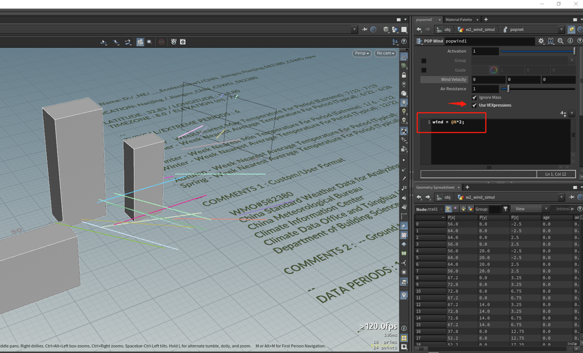

Hi I'm trying to simulate a simple wind environment with Popwind,
the pop works fine with any number input for velocity,
but when I tried to multiply it with local variables like $NX and $NZ
I didn't get the result I was hoping for.
Please help me if there something I was missing.
thanks in advance :]

for someone who may have the same question
the solution is to check the Use VEX and then simply type in "wind = @N"
