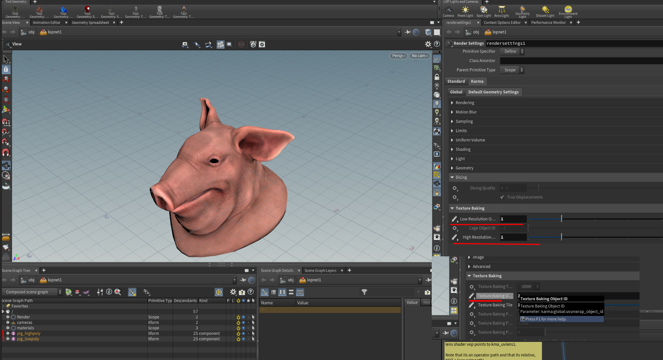

Sorry for a noob question but what is this Object ID thingy.
If instead of one pig head as in the example I would have two usd primitives pigHP and pigLP how do I tell which one is wich to the render rop? I need to mark them with some attribute with some fancy name?

Yes, the render geometry settings has Low, Cage, and High obj ID settings for correlating the primitives that are baked.

What are these ID settings? An integer, a string? Are they applied automatically and how do I find them? For example, if I have a cube and a sphere and I want a baked texture of only the sphere (but with the shadow cast from the cube, etc). Is it possible to set those ids?

Thanks @jsmack! How do you specify it?
I can't just figure out what to put there, how to tell Karma that pig_higlpoly is the high poly object and pig_lowpolly is the low poly one. This object_id thingy does not pop up much in the documentation.

Aaaaaa OK, got it.
Set the object id for lowpoly and highpoly to the same id via render geometry setting nodes and turn off the visibility for the low poly as well.
Attaching the setup image and modified hip from Mestela Hope that is ok.
