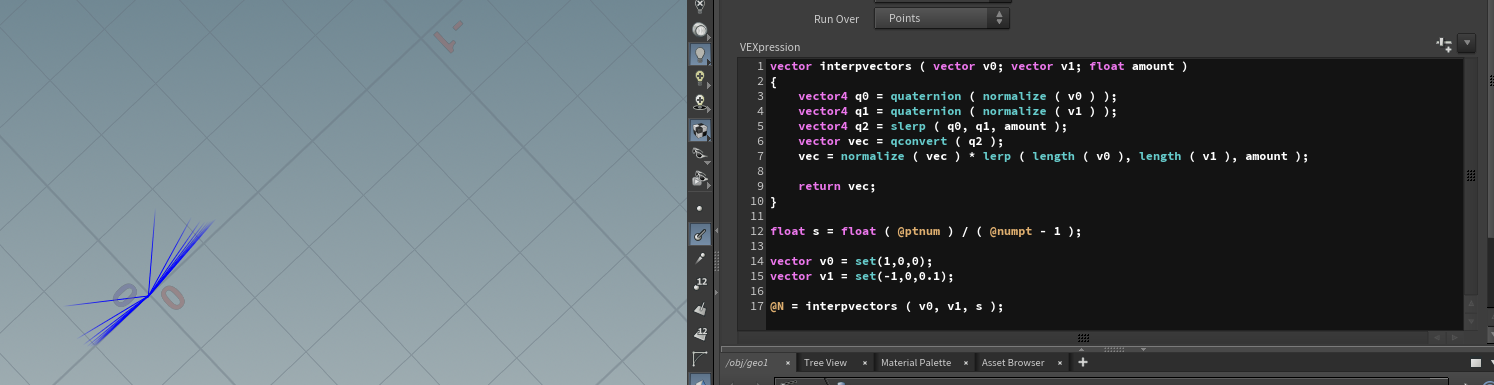

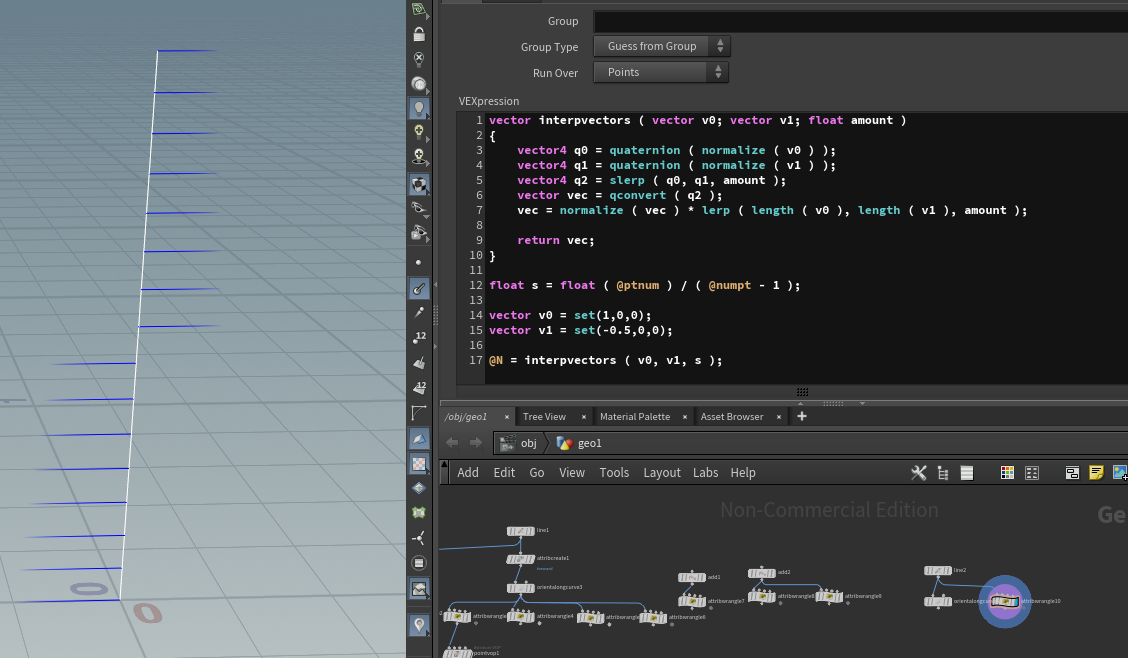

Thanks for your reply animatrix_,
I have tried something similar a little bit earlier and sadly the Problem persist. I uploaded two pictures that show my problems with this approach. I need it to loop around the line even if the vectors are 1 and -1. While that works with matrices, those only loop around the line anticlockwise.

I understand that rotating between two perfectly opposing vectors is a problem, yes. But why is the second error image, where they are not oppsing each other not a good slerp? For me it looks more like a regular lerp than a slerp where afterwards the vectors are normalized.
From my understanding a slerp along 6 points between 2 vectors that have a 100° difference should return 0° when the bias is 0, 100° when the bias is 1 and then 20°*i for each intermediate point. Am I just missunderstanding this function? Because that is not what is happening in my second error image from my previous post.

The behaviour you're seeing is due to the way spherical linear interpolation works when interpolating between two vectors that are almost directly opposite each other. When vectors are nearly diametrically opposed, the direction of the interpolated vectors can change rapidly around the midpoint of the interpolation, causing them to closely resemble the starting vector, then rapidly switch to resemble the ending vector.
You can think of slerp as an interpolation that moves along the "shortest path" on the surface of a sphere between the start and end vectors. This path is called a "great circle". When your vectors are nearly opposites, the shortest path can be almost any direction along the sphere, and the precise direction can be influenced by very slight changes in the end vector or due to floating point precision errors.
This is why the interpolation looks uniform when visualized on a sphere as it's always moving along the shortest path, but can seem to favor one vector then suddenly switch to the other when visualized linearly.
