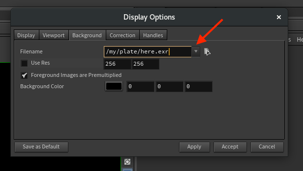

Hello everyone!
I would like to set a background image automatically using python on the render view, but without having to open the dialog box in the image...
I looked into the documentation and tried to use IPRViewer class [www.sidefx.com], but it doesn't seem to have the required methods to call and set the parameter. I have also found out that a `compdisplay.pref` file is saved with the information as background.filename, but doesn't seem to be reloaded automatically, nor I found a way to force it to reload..
Is it even possible to change the filename using python? Or is there any other idea how to solve this problem?
Captura de Tela 2023-07-17 às 17.07.33.png (30.8 KB)

Hey there,
you can do it, by calling a hscript command
copPath = "/my/plate/here.exr"
hou.hscript('imgdispopt -f %s' % copPath)

Joined: March 2017
Thank you, Chrisg~!
Works like a charm
