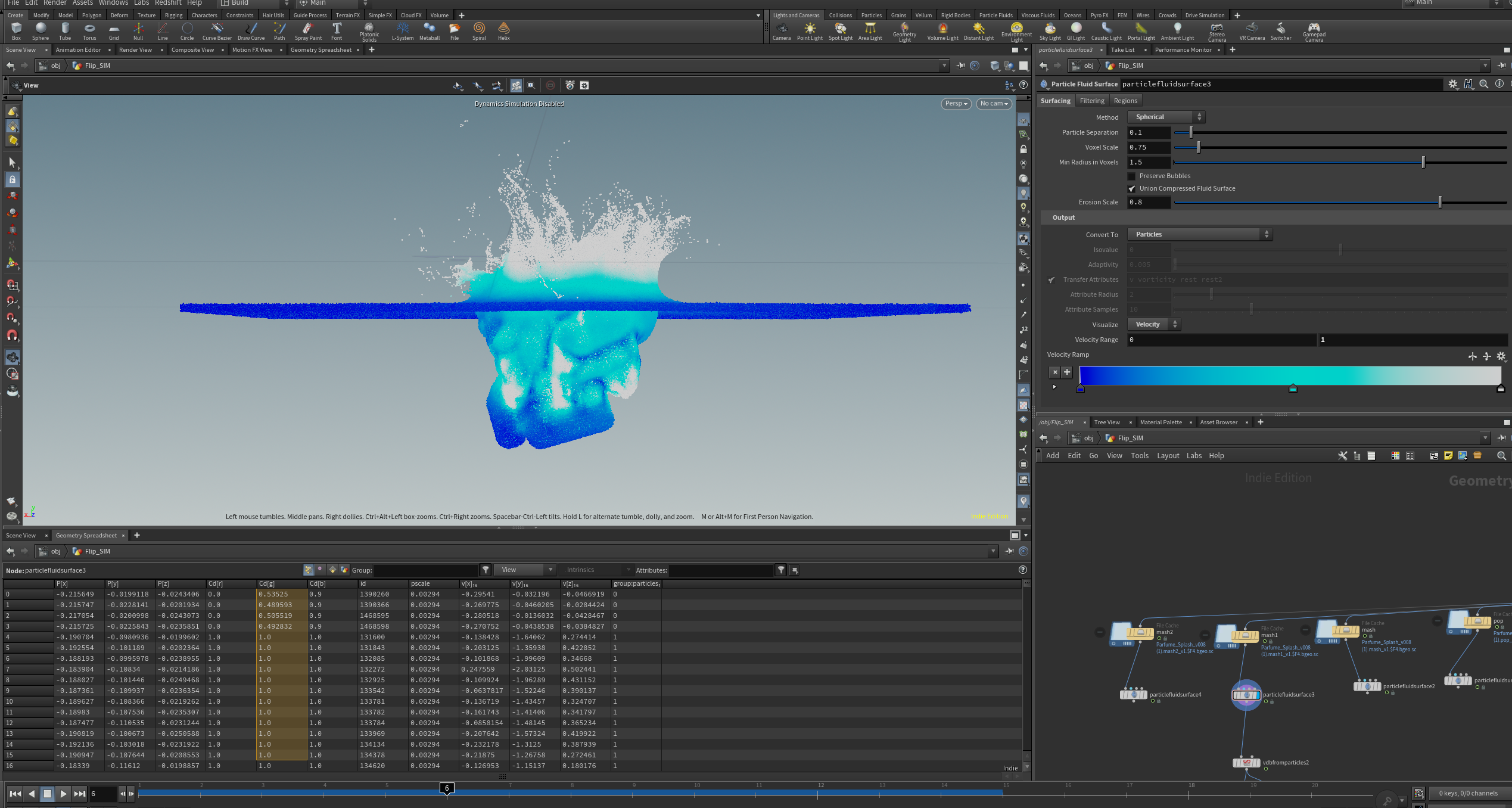

Hello, i'm trying to simulate a parfume bottle dives into a water tank and create nice tendrils with smooth splashes but i haven't seem to achieve what i'm looking for. Can someone be able to guide me through which settings i need to play with to get the results i'm looking for.
I'm playing with this paremeters mostly
Velocity Smoothing 0.1
Time Scale = 0.7
Substeps = 4-6
Reseeding = Surface Oversampling = 1.5, Oversampling Bandwith 1.5
Particle Seperation
Collision > Velocity Scale = .8
Surface Tension = 0.05
Edited by raumafu - Aug. 21, 2023 03:32:48
parfume_bottle2.bgeo.sc (4.2 MB)
Parfume_Splash_v008.hiplc (1.6 MB)
Joined: July 2021
Hello, I modified your gravity to normal and used keyframes to modify the collision speed. The speed slowed down when entering the water.(I can not speak English.The above is a computer translation.i'm not a professional.)
before repair
After repair
Parfume_Splash_v008 (1).hiplc (1.7 MB)
