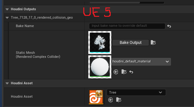

I can't add multiple materials to my HDA-generated meshes.
I created an simple tree-generator to be used in Unreal Engine via the Houdini Engine for Unreal. I created a material node containing two materials, which I then assigned to groups containing the wood and leaves respectively. When I bring the HDA into Unreal, the geometry is generated with only a single material (the default Houdini material.)

Does anyone see what I'm doing wrong? Here are pictures to help explain the issue.
(Edit: I looked at the Cook Logs and found an error mentioning the named shaders I made. Will look into this further.)

I made a little progress. I had a tree hierarchy node with "assign trunk/brank/leaf materials separately" checked. I unchecked this box and I was able to get the HDA to output multiple materials in UE5. The material slot names are not at all what I named the materials, but I'm just happy to have multiple slots at this point. And they are assigned to the correct parts of the mesh as well.
