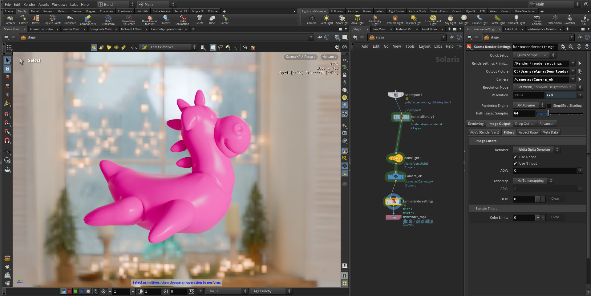

Hi everyone, I've been testing with Agx from blender 4.0 in Houdini and Maya, I think it's better in the handling of saturation and CIO color values. Best regards
Agx Punchy.png (1.2 MB)
