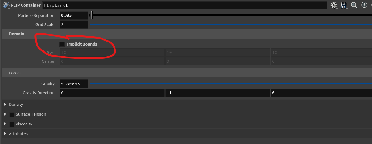

How this two separate flip domains is made? If I try to merge two geometries in a one tank, it fills empty space as well.

I believe they are just two separate tanks.
I'm kind of disappointed that SideFX hasn't added some of these cool example files from the sneak peek to the content library. Your question is valid, how do you make a non-square bending domain?

i think i found the way how it is made. Domains are merged as i tried but then need to uncheck implicit bounds, so it does not connect them. Here is example if some1 is wondering how to do it.
