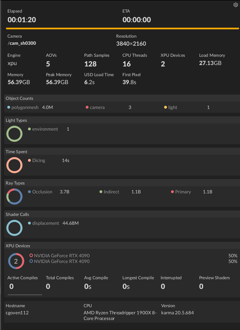

I have a similar setup with 2x4090(identical cards) and AMD 64 core 7980x. Both 4090 are on x16 slots. Rendering GPU only(embree device disabled via env. var). I'm also seeing reduced performance on one of the cards.
It manifest gradually as scenes are getting more complex. Simple scenes will render 50:50 or 49:51, render almost same number of passes. A bit more complex scenes will render 45:55, and really complex scenes will render 35:65. One card can do 100 passes and other just 60.
I looked into the issue fair bit, but could not find why. It`s not OS W11 ralated, same issue on Linux. Same on different drivers. It`s not PCIE slot/mobo/hardware level issue, because rendering on each card separatly(with optix device env. var), will result is same rendertime/passes. This issue only happens when both of them are rendering. Thermals are not and issue, both cards are watercooled hovering around 70c under load. GPU utilisation is not and issue, when i check with gpuZ, both cards are being fully utilized. It`s a mistery to me, how a 2 cards both being utilized at 100% can produce 100 and 60 passes. Is it possible that Karma stats reporting is broken? But why would that vary with scenes? too many questionn...
This performance loss seems to be specific to 20.5.x version of Karma XPU. I can render a heavy scene on 20.0.653 with 48:52 utilisation, and same file with 20.5.307 with 32:68 utilisation.
Is there anything else worth trying that will help us locate what`s causing this?

Thank you, I tried those env. vars and others(listed in docs) and found out what the issue is. It seems like it's connected to viewport/live render, meaning rendering directly in Houdini, Solaris desktop for example. It seems performance realy tanks when rendering like that. As a test scene i took the Warehouse from content library, should be easy to replicate.
Rendering with same settings and samples, to viewport 7:33 and to mplay 4:14 . Utilisation to mplay is perfect 50:50, but rendering in viewport the performance is 31:68 , or 160 v 352 passes. That`s close to half speed only for one for the cards. Images for both renders attached. Hope that helps to find out what the issue is.

IPR is typically slower to render than offline (ie via mplay) for a few reasons
- IPR has less threads available to it, and set to a lower priority (to allow Houdini to keep functioning)
- IPR has mechanisms in place to allow for fast viewport updates
- etc...
One thing, try setting the "IPR DownSample Factor" display option from 2 to 0, it may help with IPR rendering speeds.
psanitra
This at least shows it has nothing to do with the internal XPU rendering code.
psanitra
I don't know why, but my guess is that OpenGL/Vulkan/UI is doing stuff on one of the GPUs.

I can confirm that Vulcan viewport(default in 20.5) is the cause of the performance loss when rendering in Solaris. Switching Houdini back to OpenGL cards are running at 49:50 utilisation(warehouse scene).
