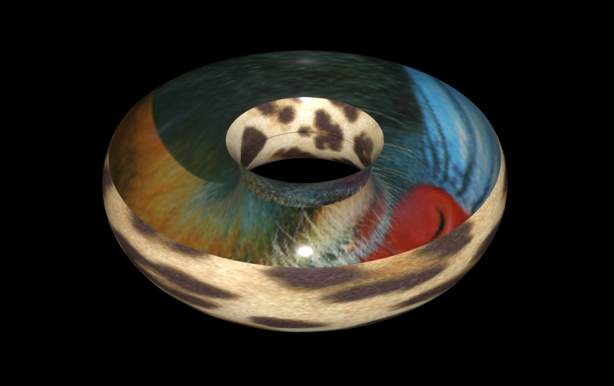

102 posts
I don't know maybe this is the setup you are after?
I think this is not yet supported by XPU
Edited by jomaro - Dec. 4, 2023 16:10:36
8120 posts
Joined: Sept. 2011
jomaro
That node isn't supported in XPU, but it's trivial to emulate it using switches going into a standard material.

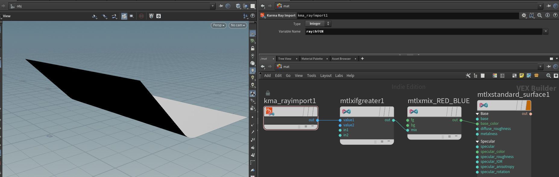

2637 posts
Joined: June 2008
@jsmack I tried the very small range numbers and very large. The greaterif didn't seem to help either.
I just wonder if the ray_import is actually working?

8120 posts
Joined: Sept. 2011
Enivob
hmm, it's possible that's the issue. There are presets in the menu that should work for getting the ray direction though. I recently used it for making a fresnel blend, since one is missing in the factory node set.

2637 posts
Joined: June 2008
That was it. Thanks, everyone!
I was using ray:hitN instead of mtlxNormal node. I guess hitN is not the same as the geometry normal.
