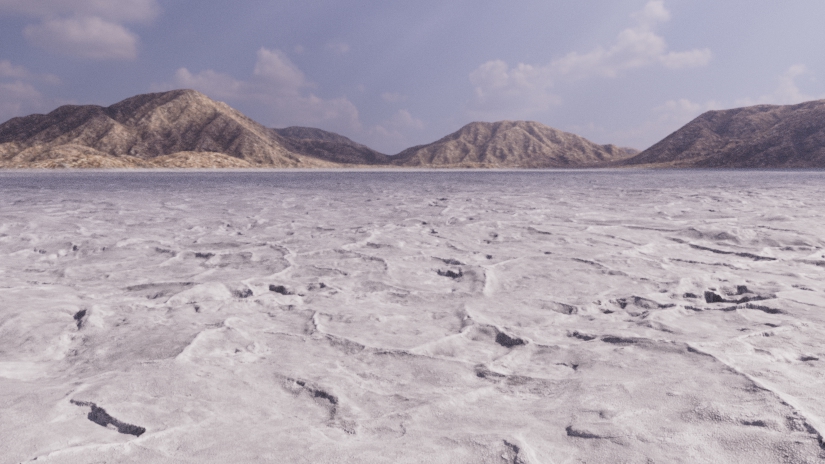

Hello SideFX,
I think I found a bug where multiple shaders are not able to layer when using two Mtlx Mix nodes.
Here's the situation:
I'm creating a large environment that features salt flats:
And I want to add some snow on top of these mountains using a layered shader approach.
