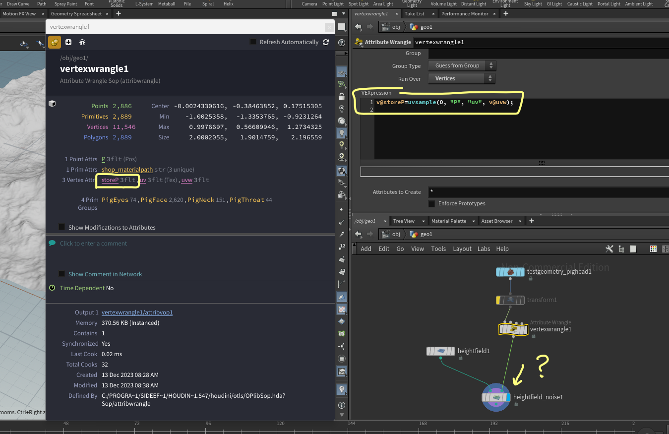

Hello @mleff,
You need to sample the 3D position of the geo having the uv attrib.
In the texture primitive/volume, the voxel position is the uv position of the input geo.
So in the uvsample function, you will need to sample the P attrib of the geo in it's uv space, using the position of the voxel (also called P in volume wrangle).
Here's a hip file with an example.

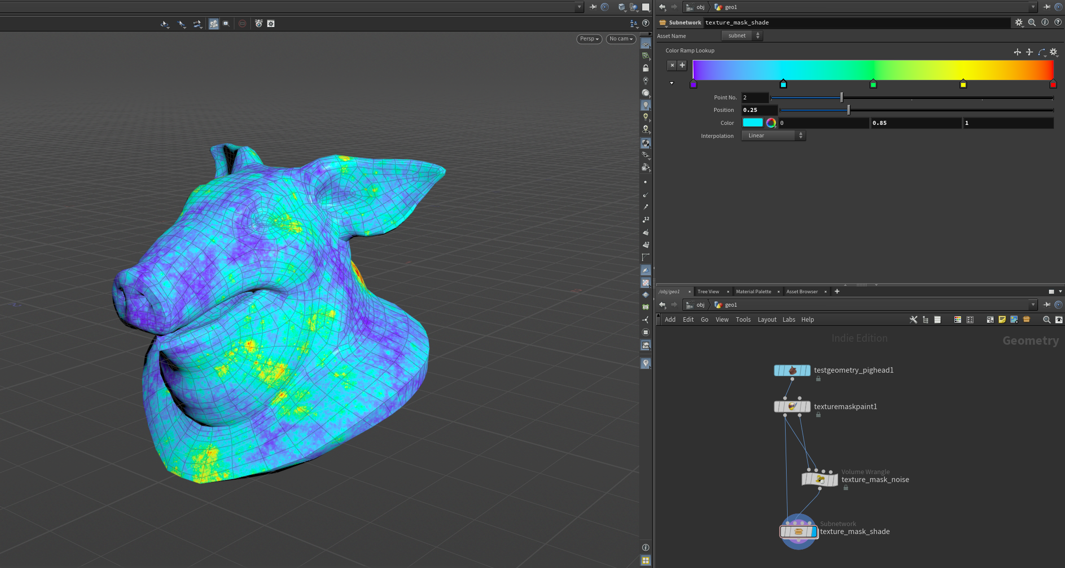

- ctrl
- 68 posts
- Joined: May 2023
@ObeidaZakzak nice idea in hip hanks.
COPS does not update the viewport natively sadly. However there is a little hack to force it to update.
A COP network node by default creates a mesh. Its at the origin. This does update when you change colours etc.
If you merge your geo in with this COP when you change the color/ramps etc. It will update. Win.
Cavet, which node should COPS display? In this COPs is a bit like CHOPs. You need to set the export flag (brown one) to the node you wish to visualise.
Last little tip, I found that leaving the COP at the default Mesh is a bit slower, changing this to Volume slice makes the update faster. Now you can update colours Ramps etc and it will update in the viewport.
With COPs Heightfields and SOPs, there is the basic structure of a texturing system there already. It needs some dev love to make it more stable and faster but Ive been relatively impressed with what you can get out of it as is. You can find some of my experiments and hints and tips over here.
