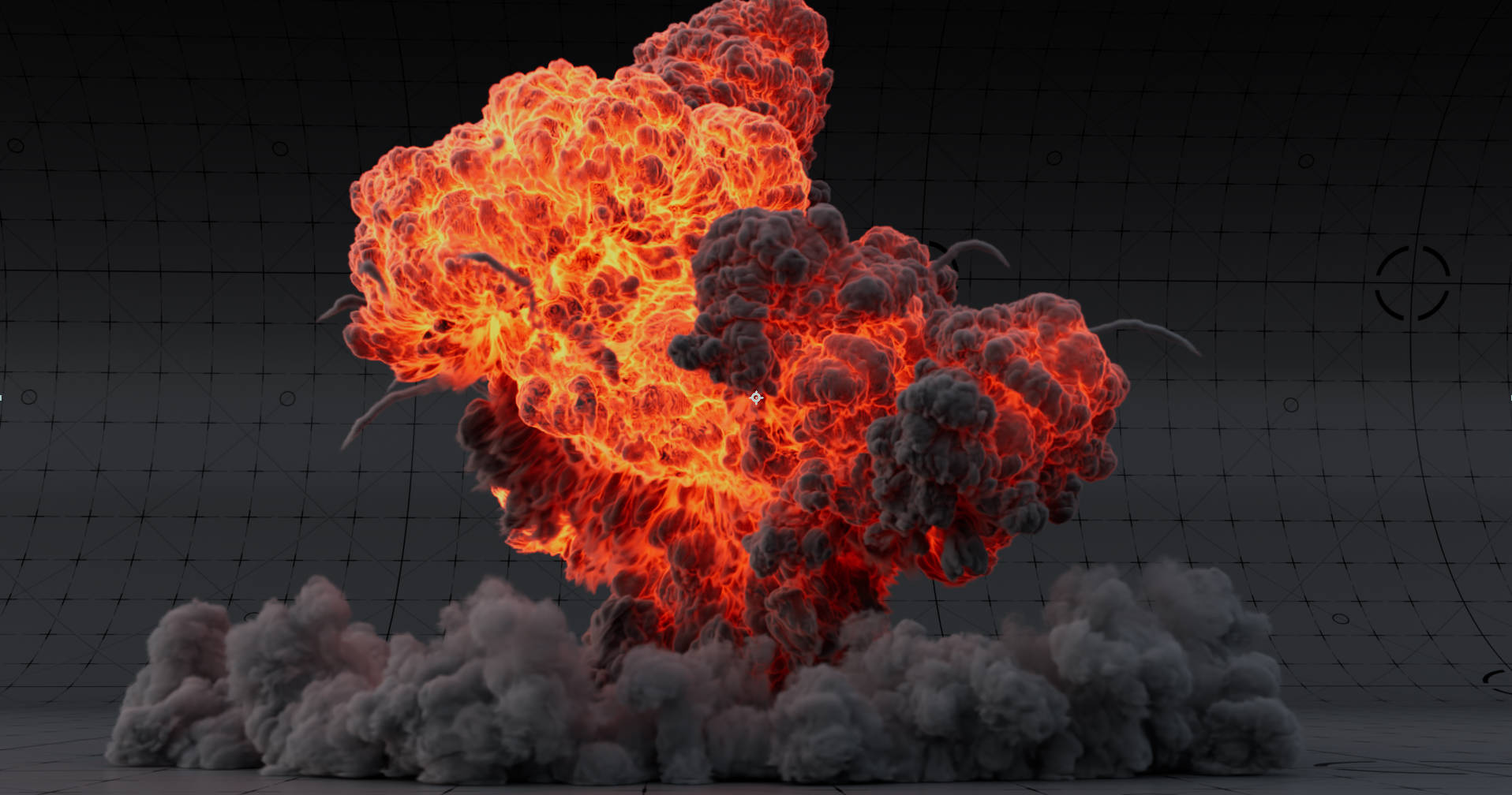

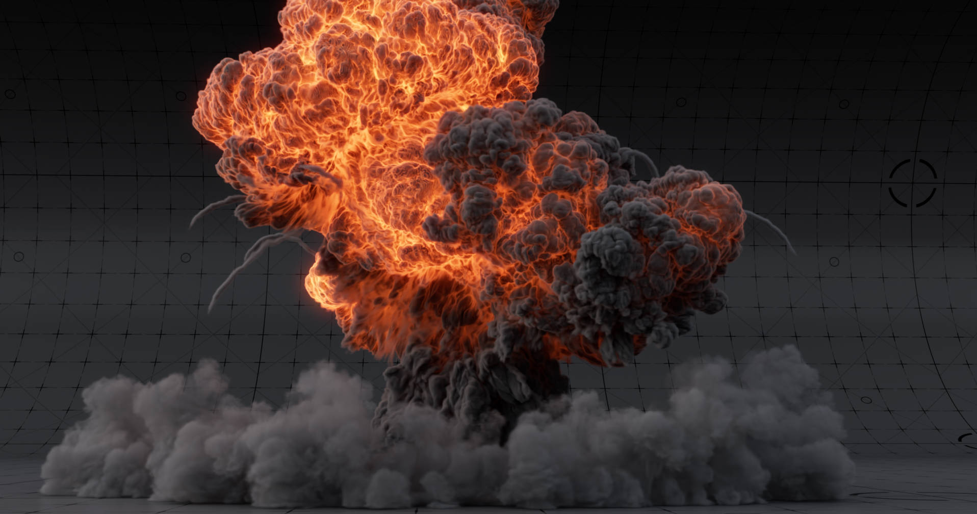

I rendered one explosion effect in acescg color space(karma xpu/exr format),but i can't get the same result in AE 2024.The color difference is huge.

Can you share a pic showing the difference between the Solaris viewport/MPlay and AE?
185 posts
BrianHanke

I just tested this with your exact setup, the default Houdini OCIO config and the AE CG config, using a pyro scene. I'm also getting different colors now.
447 posts
Joined: April 2018
Update: tested Nuke too, AE and Nuke match, Solaris viewport is the odd one out. Now that I think more about this I vaguely remember somebody telling me there was a long standing issue with the Houdini viewport clamping colors or something along those lines. That would explain why I notice a difference with pyro with many color values above 1, whereas my first test scene was all below 1.
