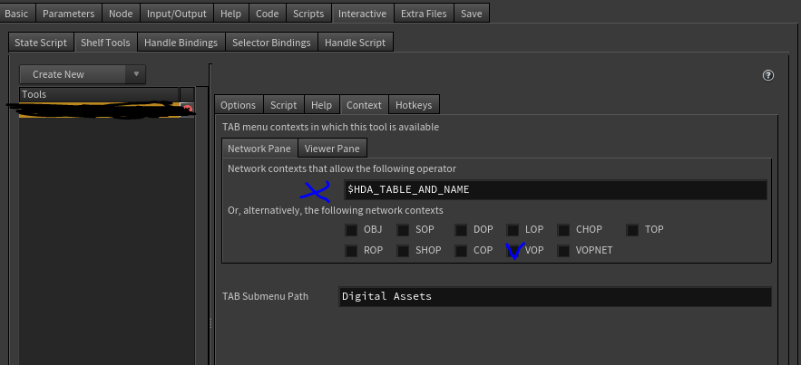

Hi!
I'm generating my own HDA with python and everything works fine, except I can't see it in context menu. Easy to fix by removing HDA_TABLE_AND_NAME and set VOP checkbox in my case.
But how to do this with python automatically during HDA creation?
It looks like there is a tool inside HDA definition, which I suppose to be able to access and modify, but can't find a way.

This post might be helpful as things don't seem to have changed and any creation of HDAs via Python does not generate the default tool by default: https://www.sidefx.com/forum/topic/85634/ [www.sidefx.com]
To basically change things after the fact you're pretty much forced to take the contents of the Tools.shelf section, parse the XML into a structure you can manipulate, add/modify whatever settings you want, then set the resulting data back to the definition.

Okay, I made it work!
First here is the documentation
https://www.sidefx.com/docs/houdini20.0/shelf/config_file [www.sidefx.com]
Graham, I then took your code, and modified this part, by adding <contextNetType>VOP</contextNetType>.
<toolMenuContext name="network">
<contextOpType>table/operator</contextOpType>
</toolMenuContext>
