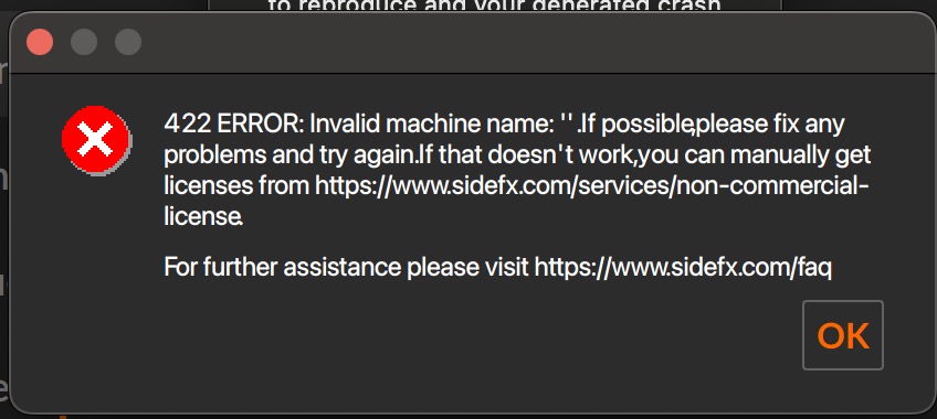

Nope. That did't help. I am not sure what I am doing wrong. I can't seem to start anything working.
I've removed all the possible traces of houdini on my machine. Installed License Server (btw I get this after installation)
When I start houdini I get this as well now:
I mean I get much more. Things like this:
I can't say I am having best time of my life right now 🤦🏼‍♂️
Edited by soswow - Dec. 22, 2023 18:58:42

I found this page https://www.sidefx.com/faq/question/im-on-a-mac-and-i-have-a-no-server-running-error-what-do-i-do/ [www.sidefx.com] which did helped with starting license server deamon back on. But I am at the square one where Houdini starts up and crashes right away.
I wonder if I have some funky Python environment that screws up with Qt or something?
currently `python --version` is 3.11.5 (installed with brew)
Edited by soswow - Dec. 22, 2023 19:16:09
