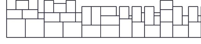

Somebody must have solved it in Houdini before. I want to subdivide a grid into random rectangles (pic 1 below). It's not really a "packing" problem as I don't need to use rectangles with specific dimensions. I generated random-sized grids and used UV Layout (pic 2 below). It works, but bigger rectangles are near each other. I'd prefer a more random look.

There's a node for this, Labs Lot Subdivision SOP [www.sidefx.com]. You need to install Labs toolset to use it.

Hi element33,
I've translated a suitable example from Shadertoy to VEX here:
https://procegen.konstantinmagnus.de/non-overlapping-tiles [procegen.konstantinmagnus.de]
While the code can be shortened it should still work.
