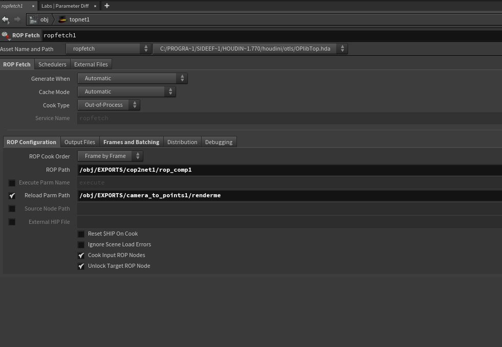

I need to press via script a specific "Refresh" button in SOPs so that TOPs cooks every frame the correct geo.
Is there a place for Scripts in Rop Fetch as is the case with ROP Geometry Output for example?

while I haven't used it, it looks to me that ROP Fetch TOP/Reload Parm Path is made for this purpose
based on tooltip, you specify path to a parm (parms?) that you want to be pressed before each frame
yeah looks like what i need but didn't work. not sure why. maybe has to do with the node i am trying to access and press the button?

387 posts
Joined: July 2018
Not working even with pre-frame script. Here is a simple scene reproducing the problem. requires a node from mlops.
There is a possibility this is an mlops bug, but would appreciate it if at least someone else can confirm this as well
