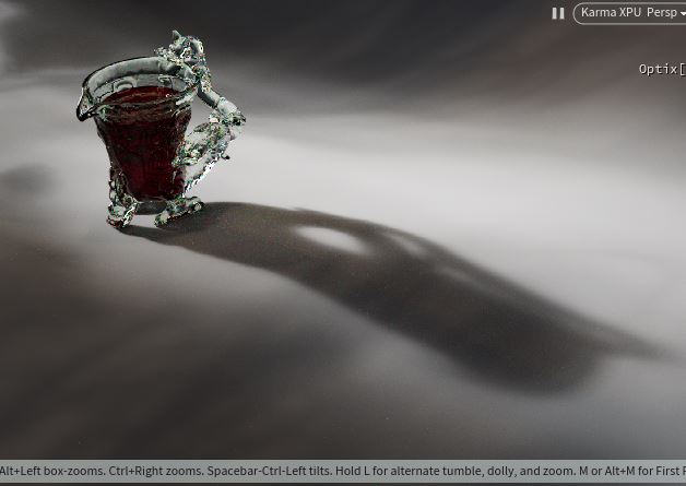

Meanwhile the caustics at home. 10,000 samples with XPU and optix denoiser. I'll have to try CPU with path guiding.
Btw Tyler, if you are doing any sort of comparisons with refractive surfaces, one thing to watch out for is the Enable Internal Reflections setting in H20: https://www.sidefx.com/forum/topic/93357/ [www.sidefx.com]
