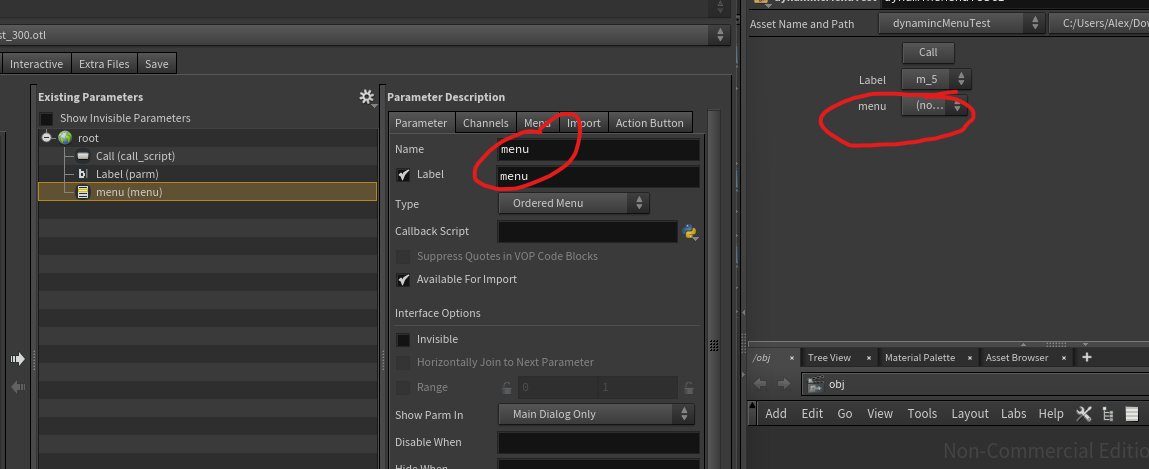

Hello everyone,
I am looking for a solution to add an item (or in a list of item / an array) to a menu using Python in PythonModule. Although I know this can be done in the menu script, I have personal reasons for needing to do it in PythonModule. Could someone please share a solution for this?
Thank you all in advance!

viklc
you can use parmtemplategroup [www.sidefx.com] to update parameter templates.def add_item(**kwargs): node = kwargs["node"] item = node.parm("item") label = node.parm("label") if item.eval() != "" and label.eval() != "": ptg = node.type().definition().parmTemplateGroup() my_menu = ptg.find("my_menu") items = list(my_menu.menuItems()) labels = list(my_menu.menuLabels()) items.append(item.eval()) labels.append(label.eval()) my_menu.setMenuItems(items) my_menu.setMenuLabels(labels) ptg.replace("my_menu", my_menu) node.type().definition().setParmTemplateGroup(ptg) else: print("set item and label")Image Not Found
For spare parameters, you can use node.setParmTemplateGroup(ptg) instead of node.type().definition().setParmTemplateGroup(ptg).
Thank you very much, Viklc. That's exactly what I need. It works perfectly!
