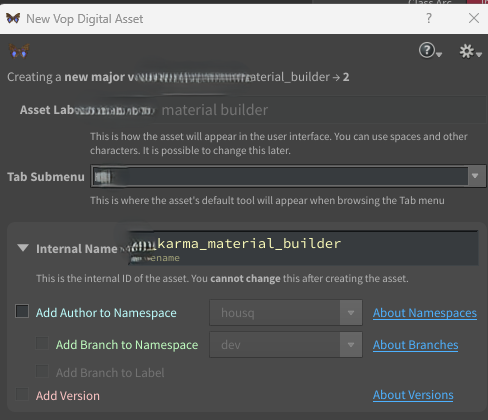

In the ‘material libray’ node, there is a parameter called ‘Tab Menu Mask’. It seems to define what kind of nodes can be displayed in the menu. I ended the name of my node with ‘builder’, and it successfully appeared in the menu.
Regarding ‘nodeFlag’, I use Python in ‘OnCreate’ to control it.
This may not be the best solution, but it has indeed solved some problems.

Yeah very cool, does seem to work. Missed the big note at top of docs for 20.0 update . Additionally if you right click 'Tab Menu Mask', can set 'Make current value Default' for custom additions. Works for in-project as far
