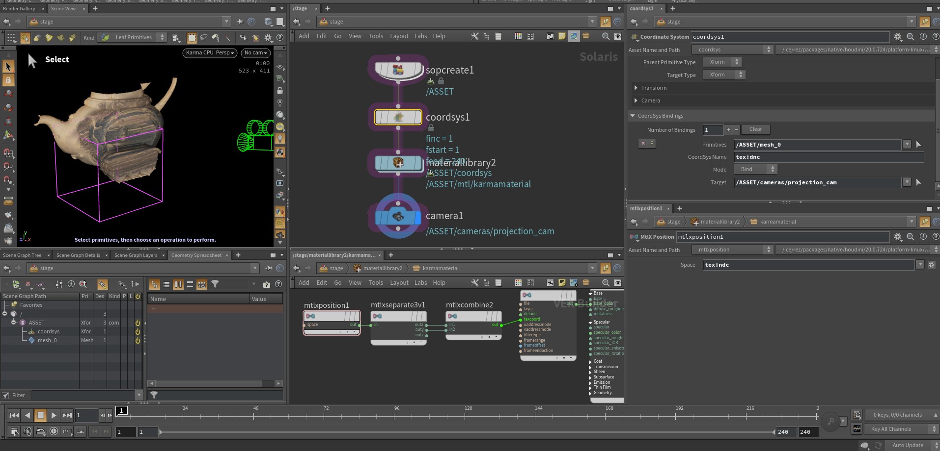

I can't get this to work, and I even thing I've done exactly as the sample scene in the docs.
I've attached a screenshot which I hope describes it well. I'm using a single image which I'm trying to project from the camera shown in the viewport. But I must be doing something wrong as all attempts as failed
I'm using Houdini 20.0.724 ( linux )
We have hoped to put Karma in production soon, but this is a big stopper for us as we do a lot of camera projections. But I'm sure I'm doing something wrong.

Solved, I just needed it to part of the root of the asset. Took me a while to understand the whole "rootless" comments. And attached a screenshot where it's illustrated.
The main issue now is that it's projecting also to the backfaces, and that it doesn't match the aspect of the camera. I've set the aspect to 1:1 but it seems to use something else and doesn't really react to change any of the paramters.
It only matches if the projection is 16:9
I hope the camera projection tools will be updated in the near future. It's really a must for DMP/environment and shot refinements.

With the swift help from support I found that the issue is solved in a later production build. The problem I had is that we are locked to and earlier build due to some plugins. So in the latest build it’s not a problem.
Thanks for the example scene though!
