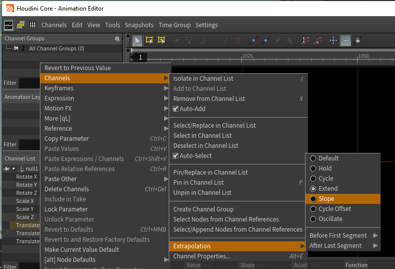

I've had this odd "aliases could not be set" error issue for a while, which prevents me from being able to set before/after. Does anybody have a solve for this?

this is a delightful and long standing bug. welcome to the party, pal.
the workaround is to right-click the channel in the anim editor list, and you can get to the extrapolation from there
