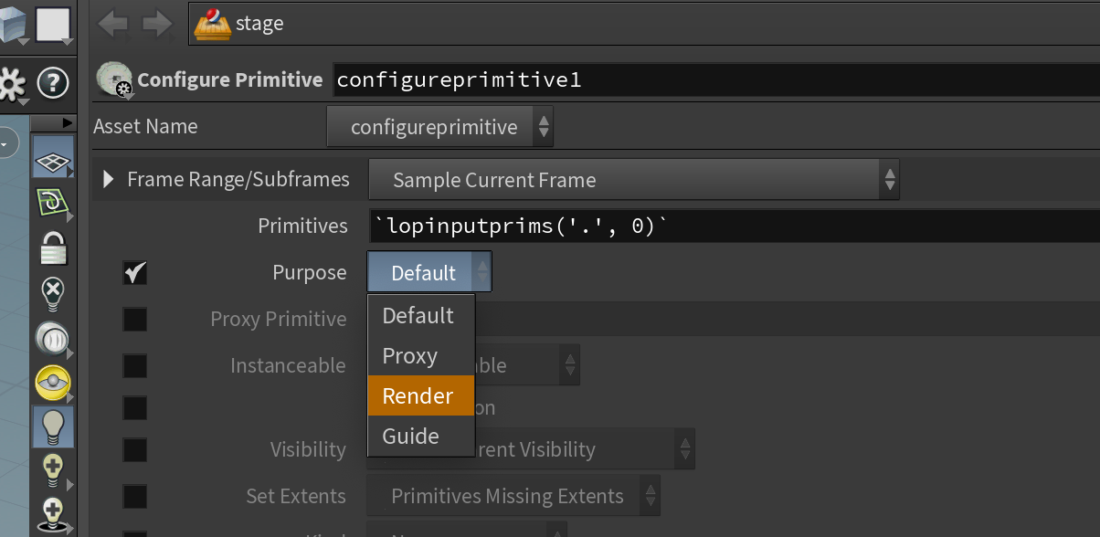

Do we have some solution for how I could switch proxy and render purpose without doing that in the sopmodify LOP ?
thanks
167 posts
Joined: Jan. 2019
You want to use a Configure Primitive LOP.
Screenshot 2024-04-24 at 15.18.53.png (136.2 KB)
