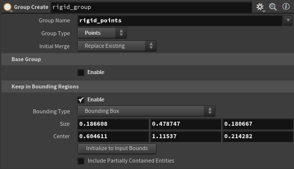

Lastly, I tried using a Group Create node to select the points of the hand and exclude them from the sim however the hand just goes limb like an empty glove lol. I'll attach a screen grab Is that the correct result? Maybe I misunderstood the reason for that

Regarding the limp hand, are there bones in that area? The Rigid Group is simply given a stiffer attachment between the surface points and the internal geometry. If there are no bones, there's nothing to attach to.
