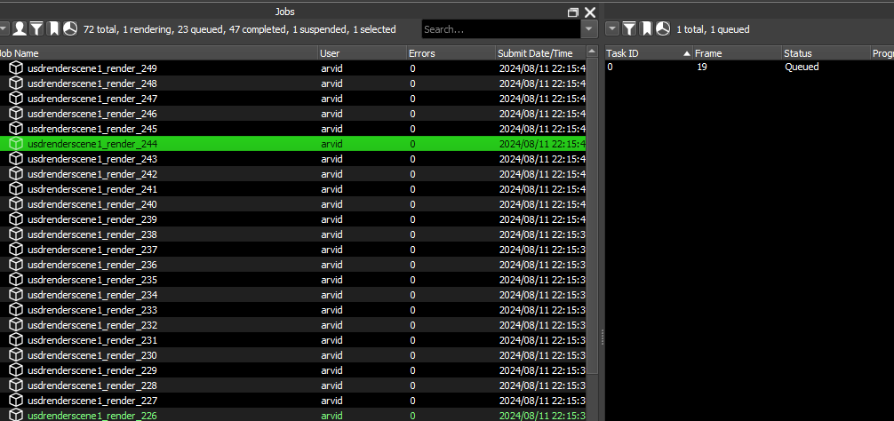

Hey I hope I can further add questions to this. I'm using deadlinescheduler for the first time in TOPs and I find it quite hard to grasp the concept. Using 20.5.278 - I want to render my karma stage with several wedge options to control lightrigs/shots.
I was expecting that when cooking the output node, that each work-item will be submitted under a single job.
This is an extract from the deadlineschedule docs.
With this scheduling type, the node also schedules one main job with a task for each work item generated
In my case, it creates a new deadline job housing a single frame.
Either something is broken, or I'm missing a setting to have a single job, with the work items as frames.
HIP file attached
Any help with this would be highly appreciate! I'm also on Houdini-and-Chill / Houdini Academy discord servers - arvidurs.
Screenshot 2024-08-11 221550.png (59.7 KB)
Hello,
This is the expected behavior in Houdini 20.5 -- a job is created for each work item. Prior to H20.5, the Deadline scheduler created a single job containing many tasks, one task per work item, however, based on discussions with the AWS Thinkbox Deadline team, we were advised to switch to having a single job per work item. This was to avoid a race condition in Deadline that caused PDG tasks to be randomly dropped from the farm. We received several reports from users about it.
There is a brief blurb about the behavior change in the H20.5 What's New help page (https://www.sidefx.com/docs/houdini/news/20_5/pdg.html):
Deadline Scheduler TOP now submits work items as jobs instead of tasks.
arvidurs
This is an extract from the deadlinescheduler docs.
Oh thanks for pointing this out. That sentence is now outdated. I'll update the help page and add the information that I mentioned here.

48 posts
Joined: Nov. 2017
Hi Rob! Thanks for clarifying this! It was driving me nuts.
Now my question to you, is it possible to let the user decide that? I mean, having an option somewhere that allows to spawn frames or jobs for work-items?
Because quite frankly having houdini deadline spawn 1000s of jobs is quite terrible if you ask me.
Especially in a shot context, imagine a shot having several render layers, lots of frames, this will become a nightmare really quick.
Is there a workaround for now, maybe using the 20.0 deadline scheduler plugin?

Thanks Rob. I think I understand the race condition (saving stale copies of the job concurrently), however wouldn't it be possible to batch work items and submit them at once as separate jobs? This behavior does seem odd to Deadline users.

There's currently no built-in way to switch back into the old behaviour of one-task-per-work-item. We could add a toggle to the Deadline Scheduler TOP node and let the user decide with the caveat that choosing one-task-per-work-item could result in tasks mysteriously disappearing from the farm. I'm not sure how easy or difficult it would be to backport such a change to Houdini 20.5. I'd have to see first how safely the two modes can live together side-by-side in the code.
Hmmm. You might be able to use the 20.0 Deadline Scheduler in H20.5 to get back the old behaviour. You wouldn't need the PDGDeadline plugin. You would just need the Deadline Scheduler HDA and supporting Python modules. So you can try this:
  1. In Houdini 20.0, put down a Deadline Scheduler TOP node.
  2. Save the Deadline Scheduler to a new HDA on disk (i.e. RMB-click node -> Digital Assets -> Save a Copy). Save the .hda to your Houdini 20.5 user preferences directory (i.e. $HOME/houdini20.5/otls/deadlinescheduler.hda).
  3. Copy the Houdini 20.0 Deadline Scheduler Python modules, tbdeadline.pyand tbdeadline_utils.py, from $HFS/houdini/pdg/types/schedulersand then paste the modules in your Houdini 20.5 user preferences directory (i.e. $HOME/houdini20.5/pdg/types/schedulers).
  4. In Houdini 20.5, put down a Deadline Scheduler TOP node but make sure it is the one that's saved in your user preferences directory.
I haven't tried the above steps myself so you may run into some issues but in theory it should work.
Cheers,
Rob
1291 posts
monomon
The race condition has to do with dynamically adding tasks to a live job, which is what the Houdini 20.0 PDG Deadline Scheduler did. Deadline's MongoDB backend is not equipped to handle adding tasks to a live job. If the live job tries to write to the MongoDB backend for any reason (i.e. writing progress updates) while PDG asks Deadline to add a task to the job, then the task never gets created. And so you end up with missing tasks in the job. This is not the case when you add new jobs while other jobs are live.
We thought about batching work items and submitting them as separate jobs rather than submitting one job per work item, however, the issue is that PDG does not submit work items to the farm in regular batches. It all depends on what work items are available at the time PDG is ready to submit work to the farm. It may have one work item available, one hundred work items available or anything in between. So you would end up with jobs on the farm containing varying number of tasks. At least with one job per work item, it's consistent and you know that each job contains exactly one task and represents exactly one work item. That also makes it easier to set a meaningful label on the job; the label can be set to contain the info of the work item that the job represents.
I think moving forward adding a toggle to switch between one-job-per-work-item (new behaviour) and single-job-for-all-work-items (old behaviour) makes the most sense.
