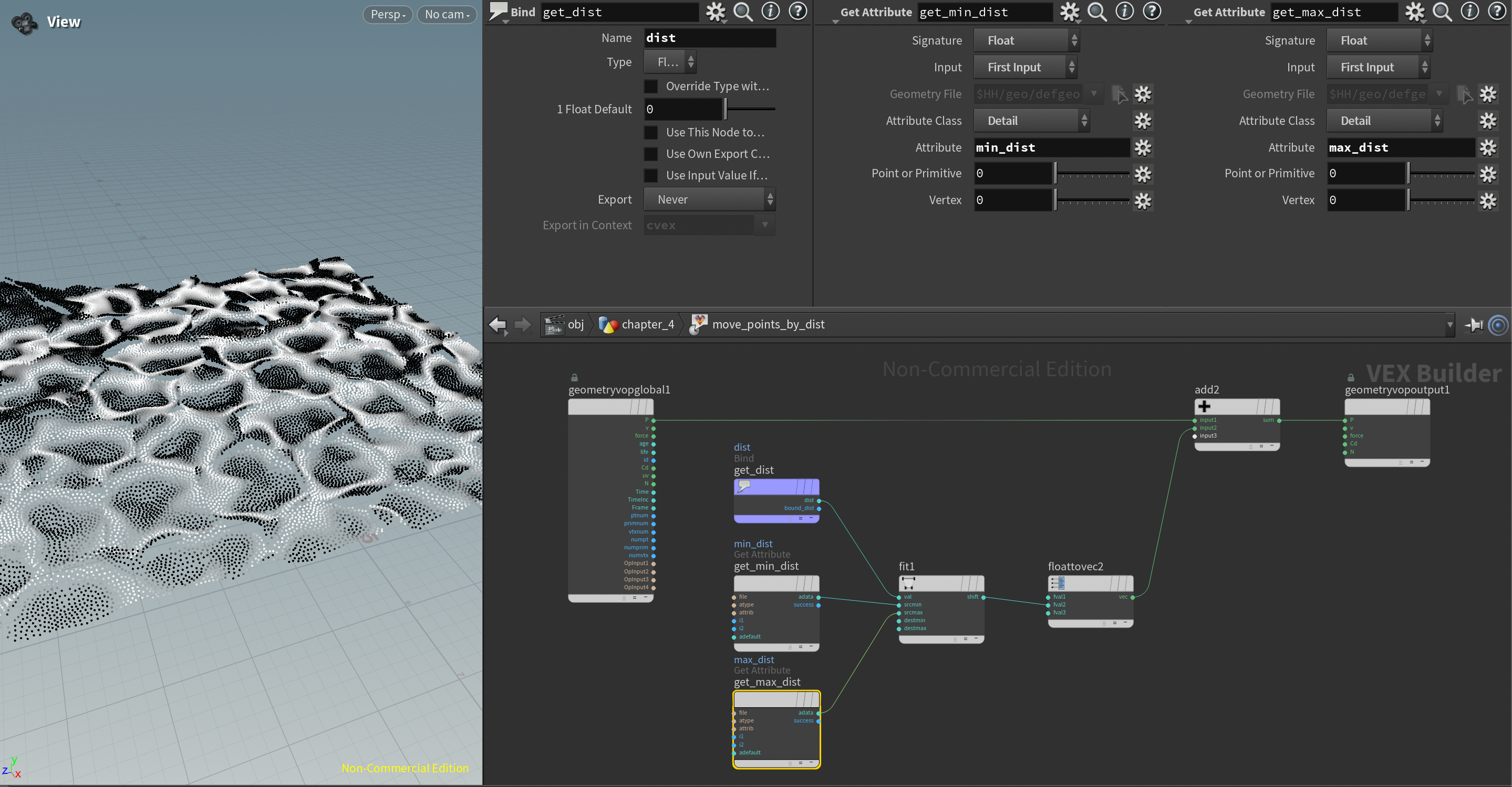

pixelninja
Before your VOP you'll need two attribute promote SOPs to get detail attributes for the minimum and maximum of the attribute.
Then in your VOP you reference those detail attributes with a get attribute VOP.
Thanks! This is a very useful method. As I am only working with points, I first promoted the attribute to detail, then promoted back to point.
However, instead of giving out value with a single number (which is my requirement), it is giving the same value multiple times, (as it is promoting the value on all the points).
I think that's what causing issue here. Based on the minimum and maximum distances, I want to move the points in Y direction. What to do now?

- pixelninja
- 45 posts
- Joined: March 2017
You have "delete original" checked on your attribute promotes so they are deleting your dist attribute.
Look at the parameters in the screenshot I sent and you'll see that is unchecked.
There's also no need to promote back to points. The purpose of a detail attribute is to have a uniform attribute value accessible by the whole geometry.
You promote your attributes to detail as shown in my previous post then read them into VOPs with get attribute nodes.
When you're reading attributes into VOPs you use a Bind VOP for reading attributes from the current geometry type (points in your case) and a Get Attribute VOP for reading attributes from other types (vertex, prim or detail in this case).
