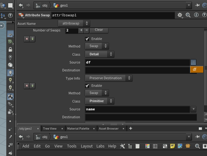

How can I achieve functionality similar to "Attribute Swap", where the dropdown menu returns the corresponding data types based on the attribute type?

Is there anyone who can help guide me? Thank you very much
