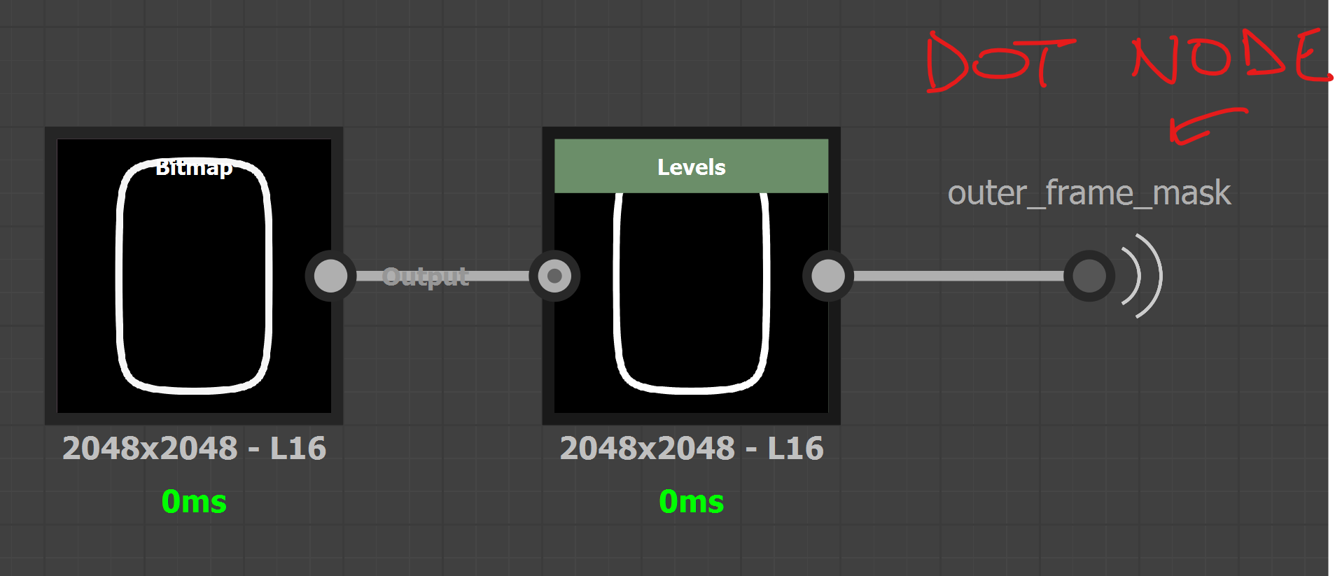

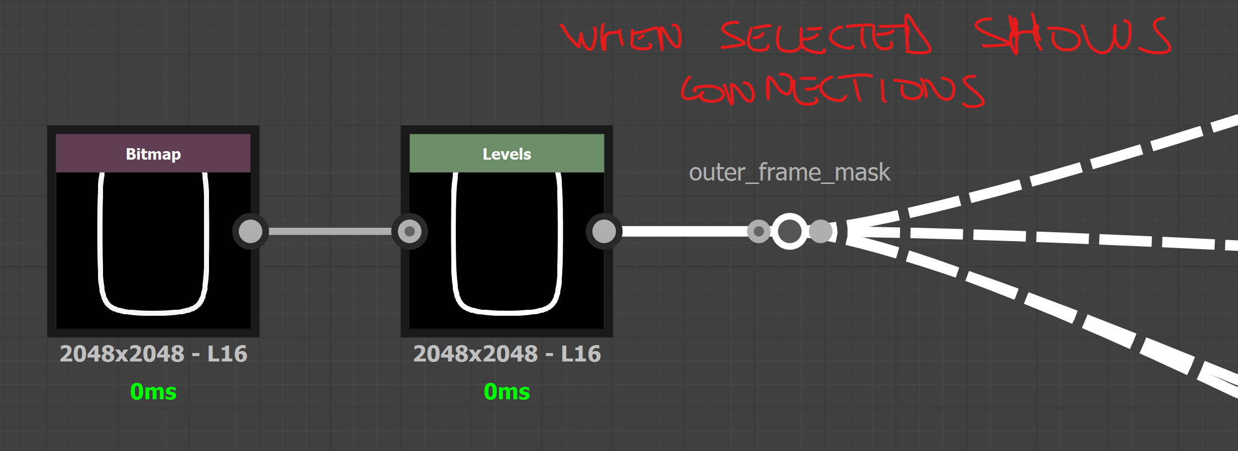

Was hoping for a node that wold help simplify a graph within the same COP network, the attachments below show how the Dot node in Designer works, which is what I'm after.
Also, if it's not just for organizing(what I was suggesting), and you just want the information to be able to be exposed.....
You know you can already create a 'dot' on a wire anywhere with 'Alt' + click?
Then you could possibly put in an RFE that information (like what you seem to suggest) could be exposed/available on those created dot connectors.
Joined: Sept. 2017
BabaJ
Yes the dot can make the wires look a little more organised but no way to avoid criss-crossing wires which is what, on large networks, hurts my brain
