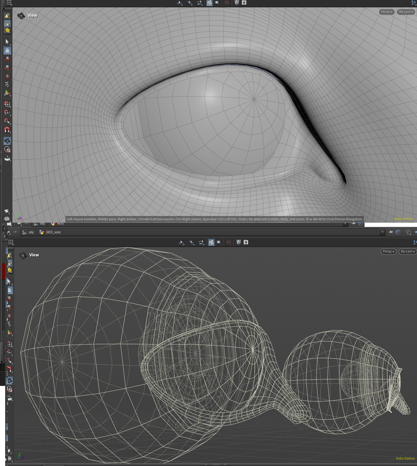

What is your suggestion for eyes with the different parts? I use the jointcaptureproximity for the eyesball, but for the rest should I use blendshape or skining?

Sebastien LevieuxHi have a look on youtube for rigging tutorials, the DCC doesnt matter. The principles are mostly the same.
Hi William,
Then try and build it in apex.
The chicken and the luchador are both set up using pose blends for the facial animation, you can have a look at how that was set up.
I am using a custom setup for the pose blends in those examples. We have a brand new pose blend component that you can use for that.
