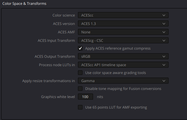

Here is what I have setup at the moment:
DaVinci resolve, ACES and Houdini

I have a Notion page set up for my own reference, and the settings on there work for me. I don't use Nuke, but I get a match between Ae and Resolve with these settings.
https://eikonoklastes.notion.site/ACES-Workflow-c82fd3912ac946cfbfab20052267fc13 [eikonoklastes.notion.site]
