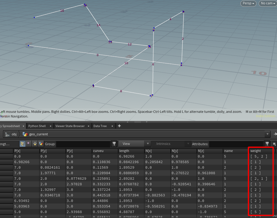

Does anyone know how to set up the weight attribute for "Labs Curve Resample by Density" node?
I have a curve and a "weight" point attribute set up as an array but they're not working.
My goal is to resample the curve with custom lengths in the attribute.

it is just a simple attribute, does not need an array.
